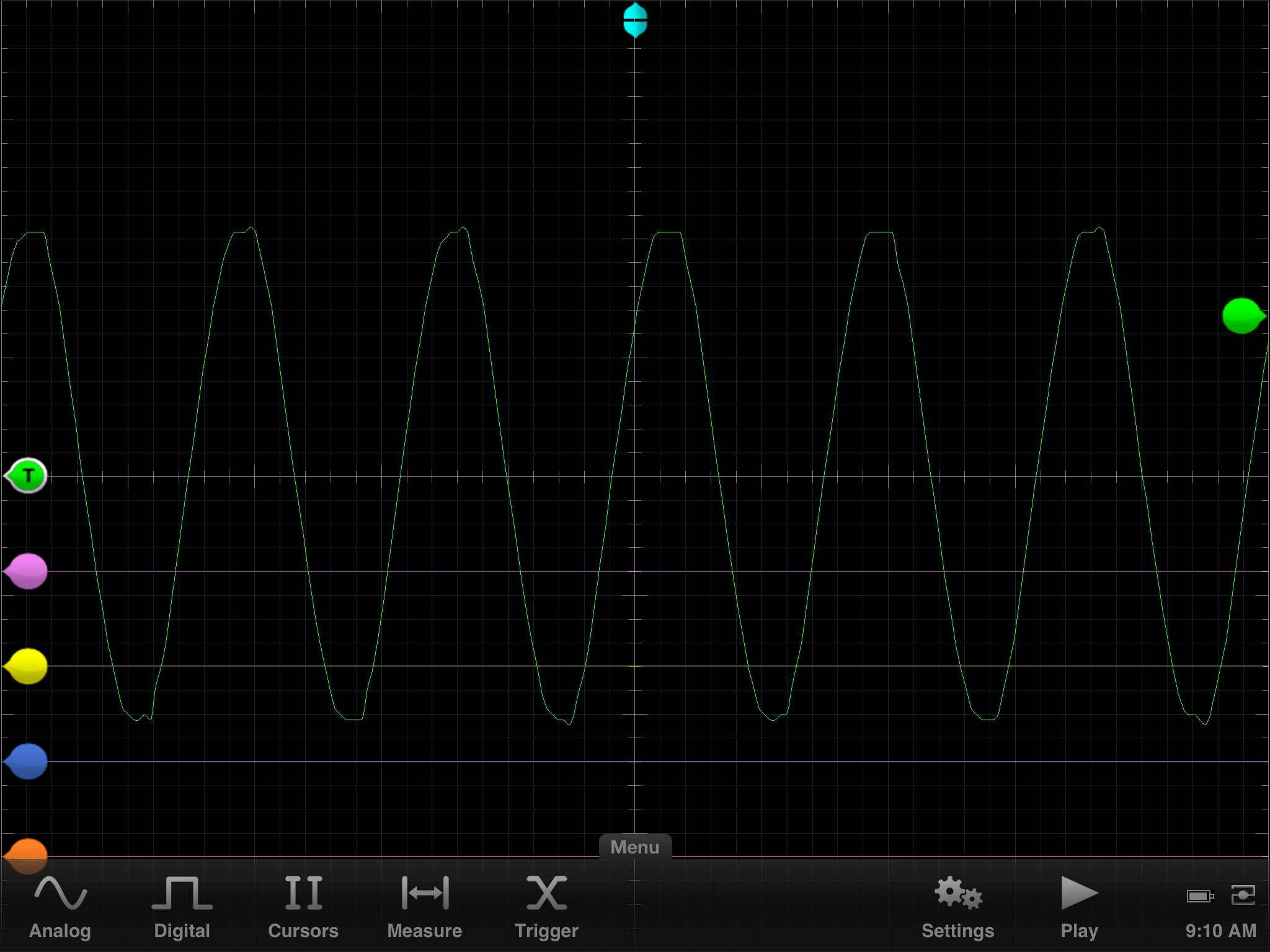

My fiends custom wound AT6007 buzzed when the Plasma display was turned on.
That would be one of those "Doctor it hurts when I do this" questions.
The eventual solution was to upgrade to an LG OLED.
Here is the look at the power using my friends iPad oscilloscope.
- Rich

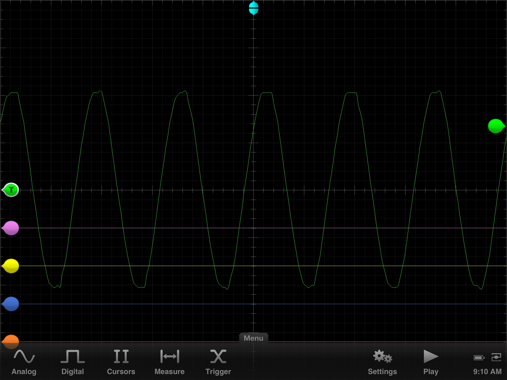

- Rich
I'm not sure what to make of it. Those sine waves are distorted, but I'm not residential power knowledgable. I'd call the power company, tell them you've had issues with noisy transformers, and ask them if they'll do an assessment.
