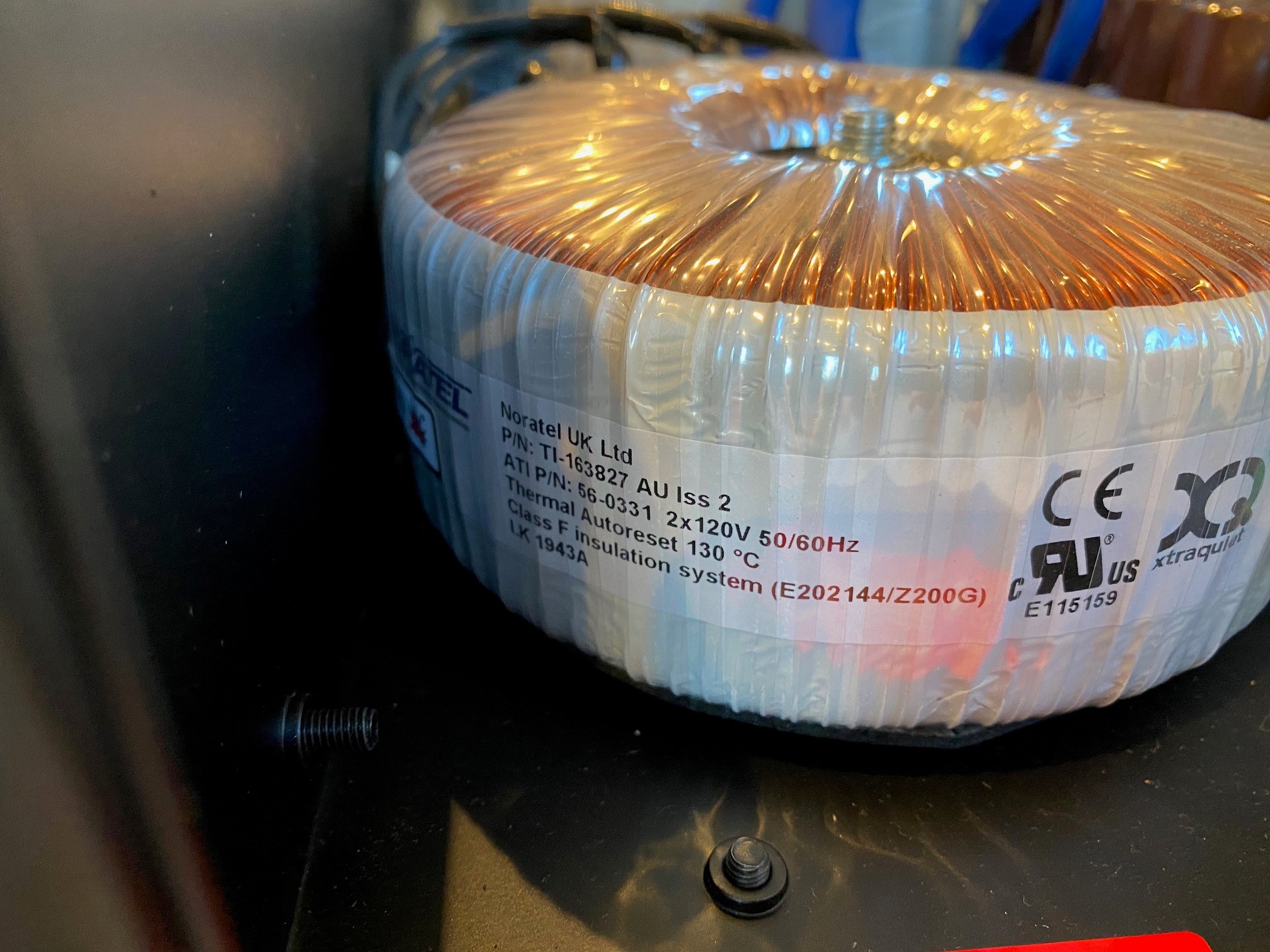

I don't know, not doubting you or anything but I remember you also said something like your ATI amp's huge toroidal transformers were silent, again not doubting you but I am 1000% sure such transformers would hum and I have never heard one (including those priced well above my pay grade) that was even near silent with ears inches from one. Iirc RichB would agree with me, but again as I said some people are more sensitive to transformer hum noise and perhaps the same apply to hiss..:D Just like I am not, or at least no longer sensitive to >12,000 Hz.

I heard absolutely NO HUM whatsoever on any of the ATI amps I've owned (AT3005, AT3002, AT2005, AT6012).

To be clear, transformer hum (the mechanical type) that is audible with ears touching the chassis is normal unless the transformer is dead or not energized. It the hum is audible from a few inches away, however quiet, may or may not be normal and may or may not be fixable with external devices/gadgets and there are many available including the usual suspects like PS Audio. As always, some may work better than others. Also, some transformers are more susceptible to imperfections in the incoming ac line.

I would agree as well based on other's feedback including yours. My comments about all transformer hum were about near silent kind of hum that can only be heard with ears touching chassis and assuming near perfect incoming line quality. If there were excessive dc., harmonics etc. in the line, then transformer hum/noise may be audible from even a few inches and again it depends on one's sensitivity to the related frequencies. There are definitely ATI amps and McIntosh amps owners reporting transformer hum, and I suspect those are made worse by the line power quality (dc offset, harmonics etc.). It could be complicated for a lot of users because some amps would hum, or rattle in reaction to the amount of dc and/or harmonics. I have at least a dozen of power amps and the one that is most susceptible is the Halo A21, the Bryston, NAd and all Denon AVRs seem immune, like virtually "silent", even when plugged into the same outlet as the Halo amp. The A21 could be near silent too if nothing else in the house is running.:D
Hiss, of course is a different animal, and that should be predictable by bench measurements results on noise.
If one can only hear the transformer hum with ears touching the chassis, then I would agree that it is practically silent, even in a very quiet room.
I can hear hum from the ATI AT522NC but only within a foot.
The AT522C had less hum than the ATI AT4002, likely due to the size of the transformers, but could also be unit to unit variance.
From my experience (in my environment) Parasound had less transformer hum than ATI.
