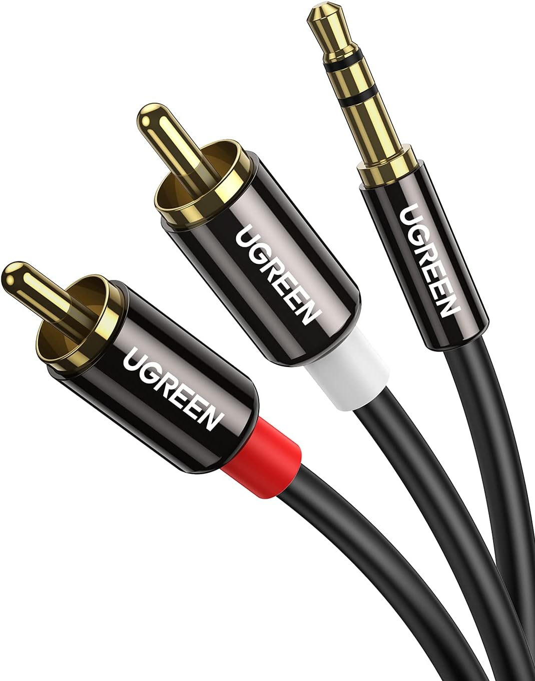

From the Video/Aux port, I have an RCA cable connected to the headphone jack of a laptop. The laptop has "Stereo Speakers" as the output type. I also tried connecting it to my phone to no luck.
Your photo shows you have selected the phono input, you should select the Video/Aux input, otherwise you will have no sound, because your laptop is connected to the Video/Aux input.

Are you using one like the following:
