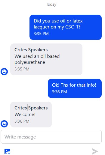

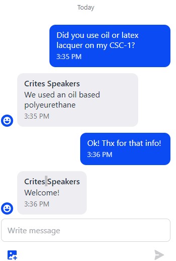

He does need to know what product was used.
