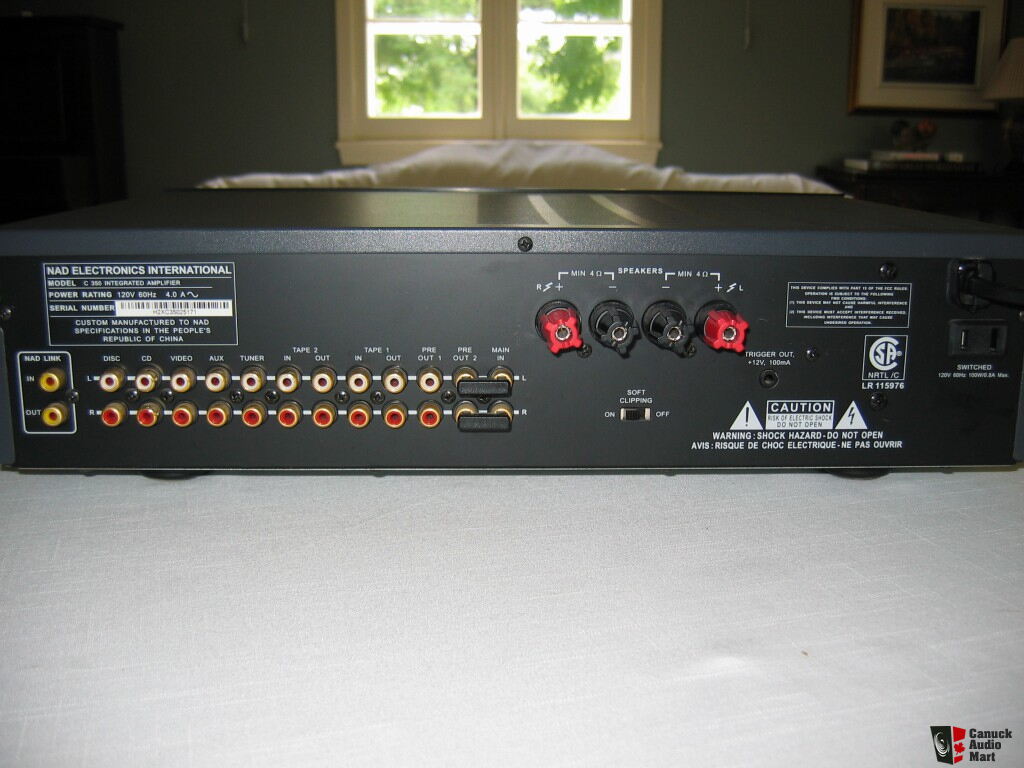

I would use the tape outputs on the NAD for these connections. The preout connections on the NAD should be volume controlled by the NAD which is not what you want in other zones. You want them with their own volume controls. You can either use a volume control, in the wall, of the room the speakers are in, or you can use a volume control/speaker selector, or you can use a multi-room controller preamp with phone control for volume.
But, it would come out the TAPE 1 OUT into a amplifier which is 4 ohm stable, then out to either a volume control in each room or a local volume control. Then speakers in the rooms. If pricing was right, you could get two amplifiers and hook one up to TAPE 1 OUT and the other to TAPE 2 OUT.
Both of those outputs should provide full line level audio to the amplifier for playback of audio in those other rooms.

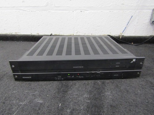

A product like this would give you solid amplification for up to three additional rooms of audio for under $150...
Back of your NAD:
pumpkinHED
Back of your NAD:
Have to say I never thought something like that could be done. I can see the tape 1 working but I thought if tape 2 were selected it would turn into the input. Or maybe the outs are just inactive (not selected) on the amp? I guess my question is, if neither tape (1 or 2) is selected, is there still an output signal from the amp? I'm imagining if I'm playing a CD I need to select CD to hear it. If I select tape 1, I get that that can act as a 'record' signal and audio would get through. If I hit tape 2, I thought that meant the system is looking at tape 2 as the signal source. Hope this is clear. And thanks for the idea!
BMXTRIX
BMXTRIX
Generally speaking, my experience has been that if you select 'CD' as your source, then 'RECORD OUT' will be the 'CD'. The only time 'RECORD OUT' won't match the current source (maybe) is when you select 'TAPE 1' as your source. Then, it won't loop back out to record itself, creating a feedback loop.
