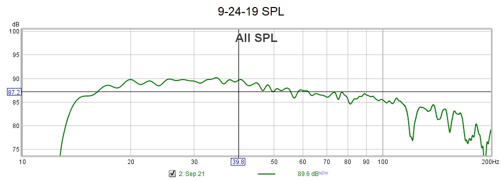

3) This is nitpicking I know, but it's become a convention of sorts on the forums to adjust the y-axis range of graphs to get 5 dB/div. Using 10 dB/div or larger tends to hide problems.
I agree, and meant to change that. Here's one that is.
Little bit of a house curve in that one. No smoothing.

I'd be thrilled if my curve looked like that.
I am, lol. That's after generating some filters from my spl sweeps in REW. No manual EQ. What you're attempting to do seems to me to cover a lot more bases than just spl. I'm keeping an eye on this thread and watching your progress. As it is now, I think it sounds awesome, but I learned early on that "awesome" is pretty subjective. Until I've heard better, my perception of awesome could be off. I thought I had awesome with a pair if 10" Klipsch subs until I heard better.
