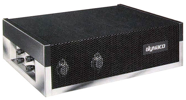

So this is what you have for an amp.
That is not a tube amp and nothing like a tube amp in characteristics. It is an early solid state amp from the early seventies. I happen to have one. My grandson is using it now. Not sure it is working currently. I have fixed it numerous times. I was given it by a close friend after he got fed up sending it me to fix after he like you upgraded speakers.
By modern standards of the time the performance of that amp was not of the highest. Although rated to work with 4 and 8 ohm speakers and deliver 65 watts per channel, it does not like 4 ohm speakers. The clue is that power does not increase at all into a four ohm load.
You have to assume that modern speakers are going to be 4 ohm whatever the manufacturer says.
So I think if you are going to move up from the type of speakers that amp was designed for, then I think you need new electronics.
In the early 70s there really was only one amp that measured and was as stable, in fact more so, than tube amps, and that was the Quad 303.
All other transistor amps of that late sixties early 70s were not as good as tube amps, like the Dynaco Stereo 70. I also had one of those for a while, just out of curiosity and sold it.
So my advice is to leave your system as the period piece it is. If you want to upgrade, then I think honestly you need to start from scratch.

nope nothing like it.. look up vta (vacuum tube audio) st 120...all tubes...60/channel ...they are kits based on the original dynaco amps back in the day...all tubes no semiconductors and has two pretty massive output transformers.

So here is a link to the amp you have.
That actually looks like redo of the Dynaco ST 70 tube amp most likely.
So you now need a speaker with a very even impedance curve. The reason is that tube amps are high source impedance amps. So tube amps frequency response tends to follow the impedance curve of the speaker. That is why in the old tube era Raymond Cooke of KEF used to impedance compensate his crossover circuits.
Direct coupled output transistor amps are a low source impedance. So modern speakers generally have an impedance curve that looks like the "Rocky Mountains". So that means that tube amps will perform differently with different speakers.
If it is a clone of the old Dyanco stereo 70, then it should have a tapped output transformer to allow for 19, 8 and 4 ohm speakers. However that does not solve the violent swings of impedance and phase angles of most modern speakers.
