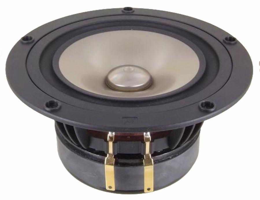

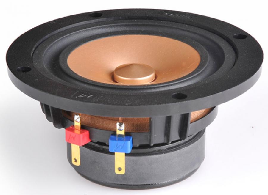

The direct descendants of those driver are the Mark Audio drivers.
These would be good value.
If you want one a little more sensitive and powerful then use this one.
Put this unit in a well damped sealed box, 0.2 cu.ft.
That is a much better solution than tweeters placed in front of the cone.
