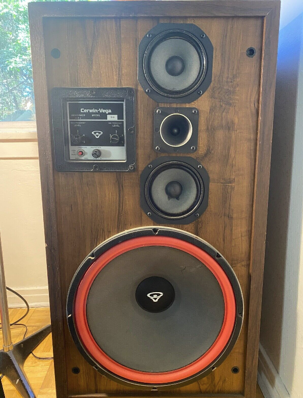

I just recently purchased a 4B Bryston amp, 2 cerwin vega D9 and 2 cerwin vega D3 ( D3 where added to help prevent clipping)
I know everyone states this should be loud enough but it's not, I like it loud. If i give it more volume than 3 o'clock it clips. I'm thinking of purchasing a second 4B and somehow running 1 amp for each side of speakers. Not really sure how it's done.
Any guidance would be greatly appreciated.

You have committed a howler. You never use two different speakers connected to the same amp. NEVER! That will create a complex load. If you ran an impedance curve on it, about it would be a nightmare. So you are most likely clipping because the amps can not provide the power to such a complex impedance and phase angles.
So, job one is to get rid of one set of speakers now.
The other issue is that you may well have already damaged that 4B Bryston amp with that abuse.
That amp is 300 watts per channel. the Cerwin Vega D9 are 350 watt speakers, and 101db sensitivity. That is quite enough power to render you stone deaf for the rest of your life.
You do not need more power, just correct engineering and not the Fred Kano variety which you have now.
At first I thought the 4B referred to four amp channels...but looked it up and wondered then how you were wiring things up. I'd just use the D9s with the amp myself.
