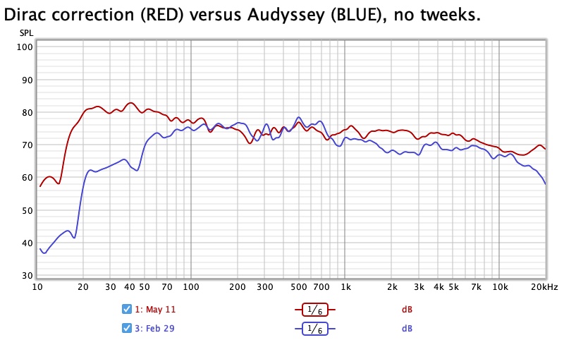

Well, in my case I made REW measurements, to confirm what Audyessey and Dirac did to the sound from my systems. Of course, I still cannot evaluate my
"Subjective, personal preference, skill and knowledge..."! All I have is REW...

Well, in my case I made REW measurements, to confirm what Audyessey and Dirac did to the sound from my systems. Of course, I still cannot evaluate myView attachment 67944 "Subjective, personal preference, skill and knowledge..."! All I have is REW...
Audyssey is famous for ruining bass and cutting highs...as per your results.
(I had a Denon but dumped it...not a fan of Audyssey and Dynamic EQ/Volume.)
Looks like you could have got the same results by raising/adjusting levels and playing with the manual EQ though.
(But isn't that what these correction programs are doing anyhow?)
Yes, I could and did get similar (but not as accurate or as low, sub 20 htz) results in the bass region with Audyssey, by adjusting bass gain by 8-10dB, but I had lost faith in Audyssey. And the high end is also superior with Dirac. Now I have to tweek Dirac, by moving the dots in to elevate the ~100-500 htz, 'warmth region'.
dlaloum
Ive decided to rerun the narrow positions. The middle one. Im going to keep that as my default, save it as RAW and then screw around with the handles as you say and save diff ones. The cool thing I do like is that I can save up to three slots and with the controller just go thru them. I do think its cool, Just not 100% sold on it yet. I did accu eq and well it didnt sound as good as dirac IMO. It was missing the enveloping sound that dirac gave me.
What kind of confuses me is the crossovers it gives. Sometimes its giving diff crossovers for diff speakers even though the speakers are the same. Accu EQ gave me 30hz as my front crossovers. Diract gives me 70 which Im thinking is more accurate?
My sub is at 120 but to tighten it do I just drop it to say 100 or 90? This is all on my Onkyo of course.
It's not perfect... the algorhythms have multiple possible "correct" answers... and many people have observed that some manual adjustments of the XO's have improved or degraded things...
If you have the equipment and the inclination, measurements with REW of the post Dirac EQ result in your space, can sometimes identify issues, which can then be corrected by shifting the XO slightly (followed by remeasure, re EQ, and recheck with REW!)
It would be nice if Dirac also provided an ability to measure post EQ, to verify the software estimates - and potentially go into a feedback loop of subsequent adjustments.... but if wishes were fishes...
