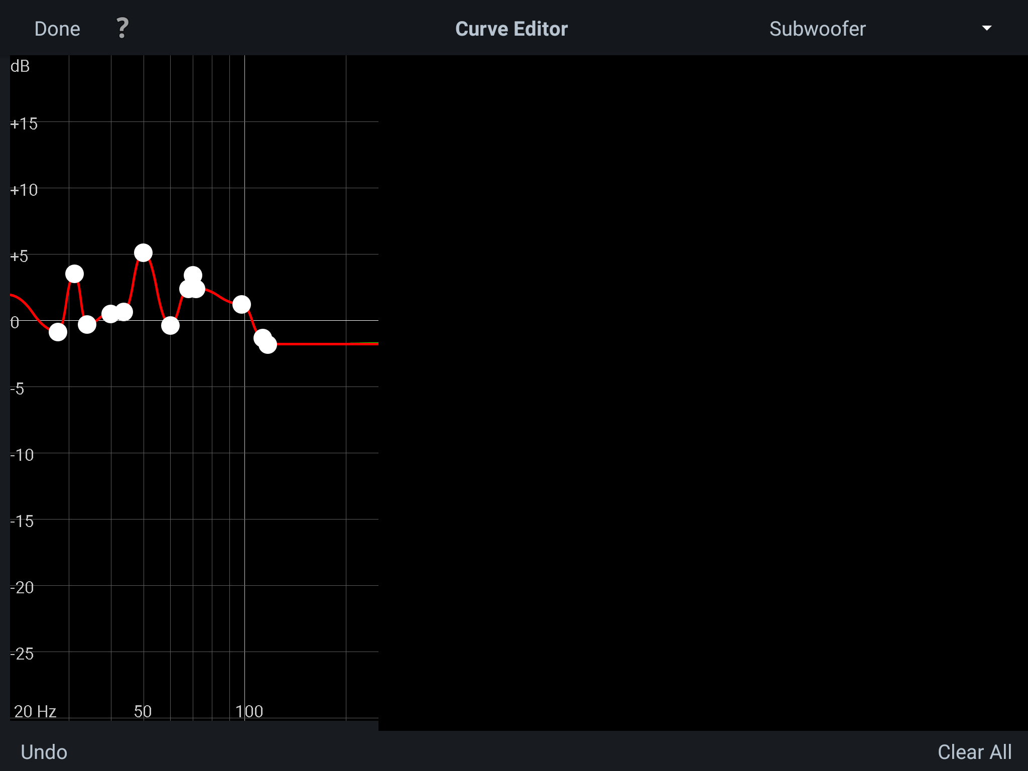

I posted an example ( I made it like that just to show what you can do if you want, in practice, a smooth tilted curve is probably all you need, to simulate Dirac's), in post#14:
That's just using the $20 app with Ratbuddyssey. Obviously if Dirac Live is doing what you want it to do, there is probably no point using Audyssey, but for those who don't want to pay extra, the $20 app is probably a must.
Those with infinite patience and are good with their fingers, or touch pens, could almost do it without using Ratbuddyssey.
Yeah, I know that, for example Gene, maybe with infinite patience, has posted REW Audyssey result curves similar (but better with more sub 20 htz bass) to my initial Dirac REW result done without tweeks. Gene even, if I remember correctly, incorporated full range left and rights into that curve, using new (with Marantz) possibilities for integrating such rare, truly full range speakers/amplifiers (that do not display intermodulation distortion being driven full range, which is rare based on Erin's many measurements, see Erin's Audio Corner, https://www.erinsaudiocorner.com/). Gene used, if I remember correctly, the 'Pro' kit for this. Yeah, it can be done, but I was posting here for someone newer to the game, and felt that they might appreciate an objective view of what one gets, no tweeks, straight out of the gate. It was a revelation to me...
