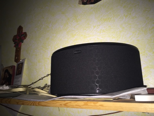

Monopoles vs dipole/ bipolar rear surrounds?
Kingnoob
Kingnoob
My shelf is pretty close to wall I’d have to add an extra board into it for monopoles.

I would just stick with what you have. A monopole may be just as compromised in sound, but in a different way, when you place it so close to a wall. That surround speaker was at least make to go up against a wall.

Yeah good idea and I think these are more designed for a back wall judging by them sealed and no ports . The bookshelves had rear ports .

If you don't put them RIGHT up against the wall, they are usually fine also. You only need a few inches.

Maybe I’ll try them again sometime all there Doing is collect dust while I use these clamshell looking surrounds .
The bookshelves are a higher build quality .

Seems like I remember the port diameter times 1.5.
Yes, but some speakers are not so impacted by it. I've had some rear ported speakers that did not care if they were very close to the wall. It depends on the tuning and how deep they extend, so while that is a good rule of thumb, it does not always apply 100%. Also, you can do things like just put some damping material on the wall directly behind or angle them slightly and it can work as well.

Totally agree on all counts. That loose rule of thumb just happened into my head.

Nope. For me, no choice. Bipoles should go extinct. Unless it’s a TINY room.

Is 12’x 11’x 10 a small room ? Haha yeah I’ll go back to bookshelves and see how they sound .

Bass can be better or worse on either. Just depends. Yeah, bi/dipoles will sound more diffused and less focused. That’s pretty much why I don’t like them. Monopoles however when too close can hotspot and be distracting. So in a small bedroom bipoles can be an ok choice.

My 6' tall Carver ribbon speakers are natural dipoles. They need 3+ feet from the front wall to avoid early cancellation, but are awesome after that. They image precisely. The back wave is for three dimensional presence in space (i.e. Real sounds tend to be omnidirectional dipoles in nature so that's what your brain is used to hearing in the real world). That's also why most box speakers sound like "stereo" and not real life, IMO. But the need breathing room and face front/back not the null to the side thing made for old style surround use. Regular speakers also have a back wave, but it's normally absorbed internally with the insulation and nowhere for the sound to go inside the box.
Bipoles are man-made creations designed to be in phase rather than out of phase relative to each other. The idea is to get that 3D presence effect without the need to keep the speakers well away from the walls. Again, that is front/back use, not facing the null area of the speaker for surround use.
As surrounds, bipoles image better than dipoles (no dead null effect to the sides), but faced from the sides, they tend to be more nebulous than direct facing monopoles. However, the angled variety on the side walls placed between rows gives essentially an array of two sets of monopoles, one facing each row so each seating area row gets even sound without having to buy two sets of side surrounds.
I use three set of bed level side surrounds in my three row home theater (front wide, side, side #2 and then rears in the back plus regular fronts), but only three sets of overheads front, middle and rear) so I use angled bipoles in the middle in the Auro-3D location so the front and rear rows get even middle coverage (faces both rows that way). I don't hear any imaging issues blending with front/rear heights.
