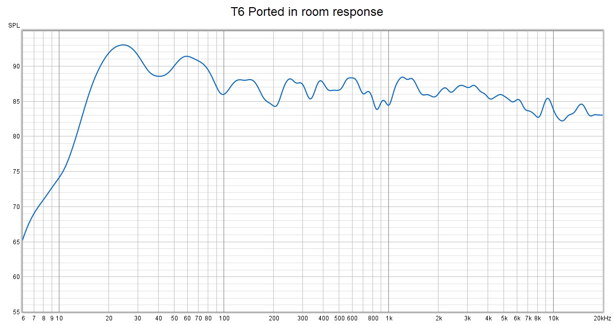

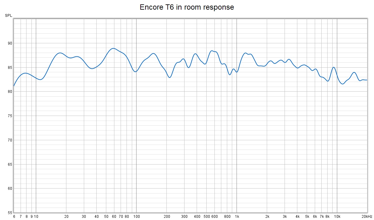

If I plug the ports I'm getting silly low response. Without plugging very good output to about 25hz. No EQ applied.
I think I'm noticing a slight resonance in the upper midbass/low midrange. I believe that's what is in the graph here:
View attachment 64150View attachment 64151
That's an interesting in room response. Especially the port blocked sweep. What are the room dimensions? You could probably EQ that flat to 17Hz, which is ridiculous for a (any) sans sub system.
About 14x17x8, open to hallway/kitchen as well.
David_Alexander
I'm gobsmacked. It's worth running a sweep after EQ to confirm. No need for subs there unless you want to have enough headroom to compensate for big, quick booms.

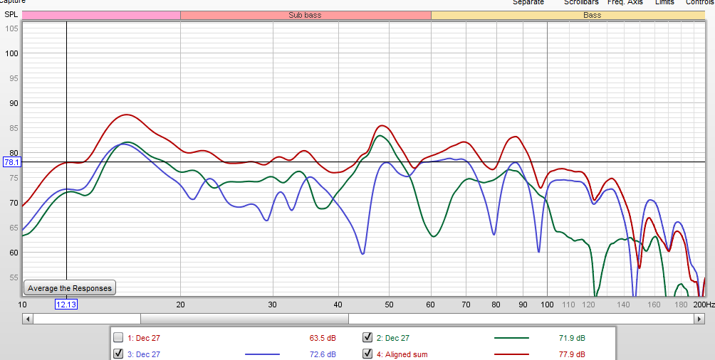

This is my unsmoothed REW of 2x M15 subs in room. Red is time aligned. That's why I'm amazed by the response of your T6 in room.
What this doesn't show is the lack of distortion from the subs. You could rack up the SPL and have no distortion down to 15 Hz.
