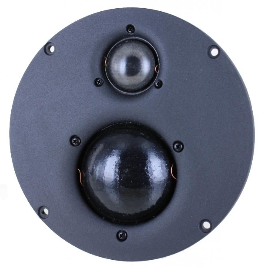

This “THX” tower has a 2-inch (excuse me) midrange? :eek:
That‘s a whole 6-Sq-Inch surface area for the midrange. Heck, my tweeter has almost that much surface area. :D
I don’t recall ever seeing any “tower” having that small of a midrange. :D
I'm pretty sure this is the tweeter/mid range combo on that speaker.
That is a high powered unit from Morel. They do not make rubbish and also hold the Dynaudio VC patents as a result of a Dynaudio break up some years ago.
The Fs of that dome is 365 Hz making the crossover on that Monoprice speaker at 550 Hz feasible.
That is a very expensive unit for a speaker at that price point.
I didn’t say it was low quality or cheap.
I said a 2-inch midrange will not have as much Dynamics as most bigger midrange drivers in other towers, especially if the 4 x 6.5” woofers are all for the bass.

That is a very narrow cabinet. So BSC will start probably around the 550 Hz crossover point. So to have a decent power band response in that crucial band ir probably does need four of those drivers.
That 2" mid is a high power, high spl. unit. Dynaudio/Moral motor systems are unique and patented. I can personally testify to the fact their drivers have a very high power capacity without distress.
I have used a Dynaudio 3" dome from 400 to 4 KHz for years and driven it hard without distress. As I stated this mid/tweeter combo from Morel has impressive specs, from an outfit not prone to hype the spec. sheet.
I'm surprised that such a high quality non Far Eastern unit was selected for a speaker in that price range.
I agree it is an unusual design, but the approach is far from without merit. So look at the specs from what I linked about that Morel unit.
When you come down to it very few manufacturers have produced high qulaity mid range units where you can comfortable use one of them.
The list would be ATC, Acuton, Dynaudio/Morel and Volt, that is about it.

2" midrange drivers can be adequate depending on listening distances and dynamic range targets. It comes down to personal preferences. I don't normally listen at live concert sound levels, but if I did, I don't think any 2" midrange could cut it. If that is your thing, you are going to want something with more cone area. But those speakers are THX Ultra certified which means they should be able to reach peaks of 105 dB at a 12 foot listening distance inside a 3,000 cubic foot room with low distortion. It has to be a pretty capable 2" to do that.

I don't think they even need to reach peaks of 105 db, this SPL is for the entire 3 way speaker, and not for each of the drivers, right?

I am not sure how THX determines the number. I would guess like a pink noise or some kind of broadband signal.

Maybe, but how about sample real movie soundtrack playback measurements?
