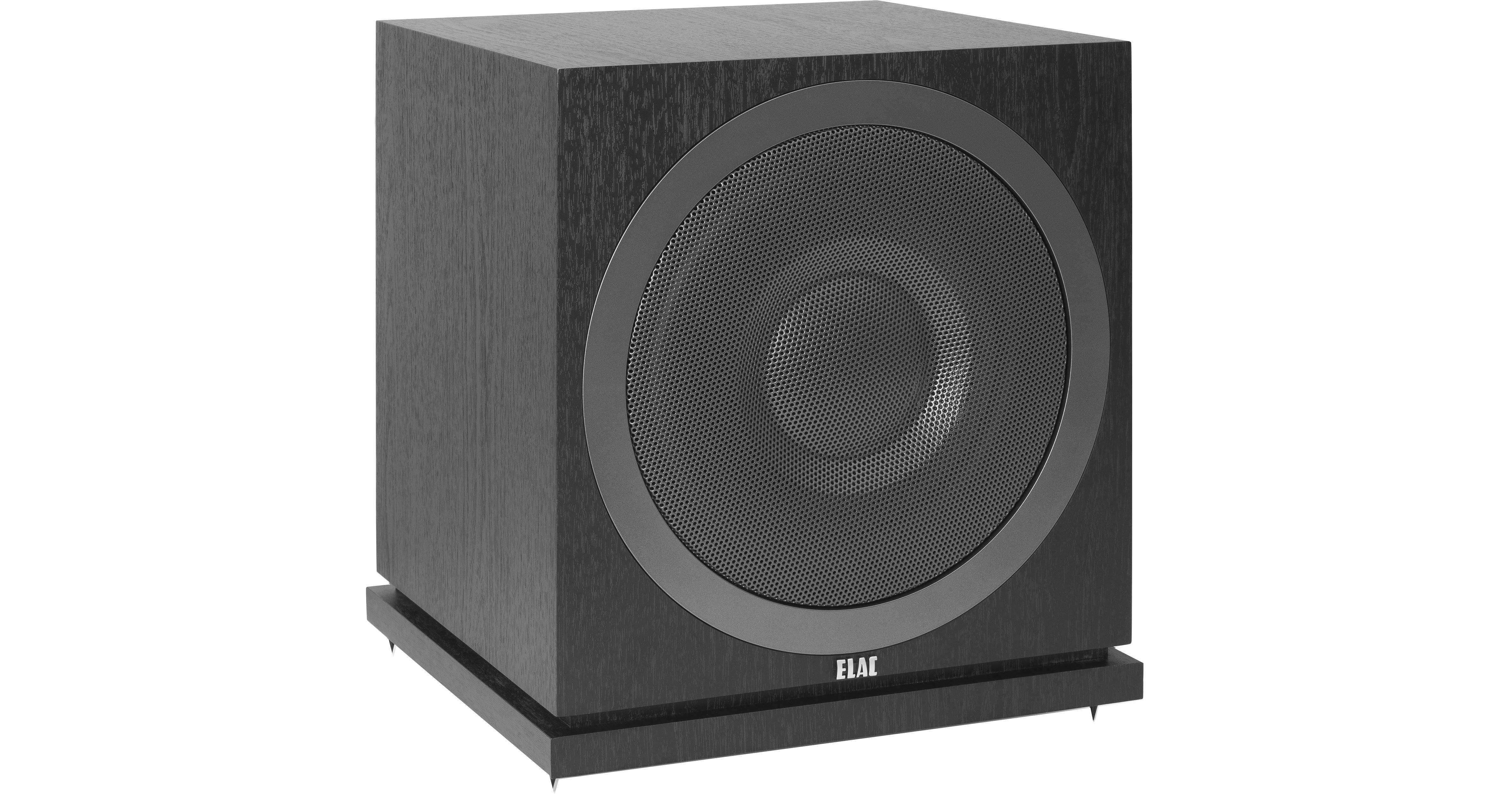

Are those any good? Because for $250 for now sounds like a steal if they are any good:
ELAC Debut 2.0 SUB3010 10" 400W Subwoofer
"Emergency call"! :D
Well, they're better priced at $250 than their list of $580....
So, this means they are definitely not on par with the other $500ish subs on my list?
Thanks! :D

Plus the elacs are only controllable via app. Deal breaker for me.
