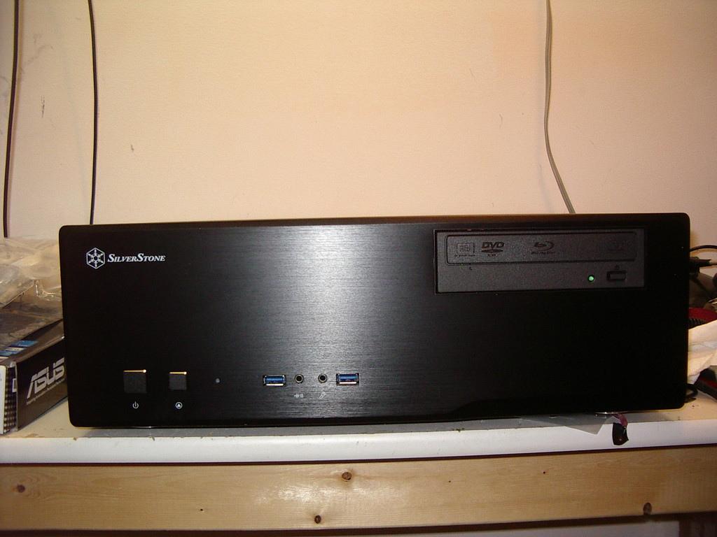

A lot of cases are not accurately drilled. When I built mine I did tons of research and this case is excellent. It looks nice in the rack and I did not have to drill out or move one whole. Installing the equipment in the case was a breeze.
It stays really coll and is silent. It looks good in the rack also.
Good choice. Silverstone is one of my favorite case manufacturers.

By the way my Silverstane cabinet is excellent and runs very cool with no audible noise.

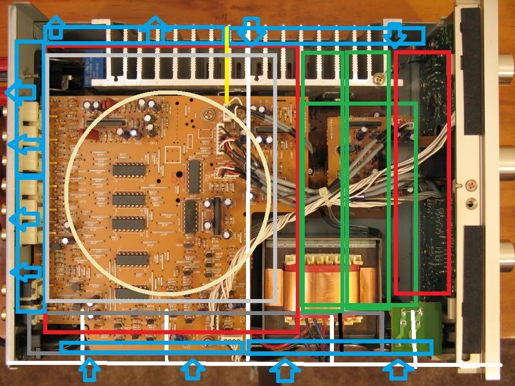

Looking at the nad, imagine updating the actual amp inside to more modern/smaller parts and fitting a pc in there.
Yeah it would be cool if you could fit a PC inside a Reciever and have it connected directly to the board and have a HTPC/Receiver all in one.
It would be what looks like just a standard Yamaha (for example) receiver but "WHalla"...HTPC combo with all the functionality of the Receiver.
