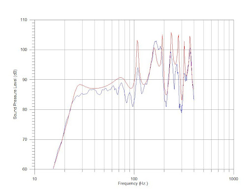

Any idea what kind of performance the thing has SPL levels and such? If that were scaled up just a tad and a Titanic 8" used would it be better than 12's I have in a bass reflex?

Any idea what kind of performance the thing has SPL levels and such? Wouldn't the Titanic 8" be a better woofer choice?
From reading about it, the enclosure was built specifically for the anarchy driver and its an excellent performer. I don't know if an enclosure could be designed for the titanic, some drivers model well in horns, some don't...
Subjectively:
this little tapped horn gives up very little when compared to a THT in room at 80 to 85 dB levels at the listening position, but it runs out of steam with higher power. Remember - we are comparing a 6.5" midbass driver to a 15" Sub driver. It does what I asked it to do very well, but comparing it to a THT at full power is like bringing a knife to a to a gunfight.
1w at 1m graph measured outside.
SPL and THD
http://www.avsforum.com/avs-vb/showpost.php?p=18393865&postcount=39
