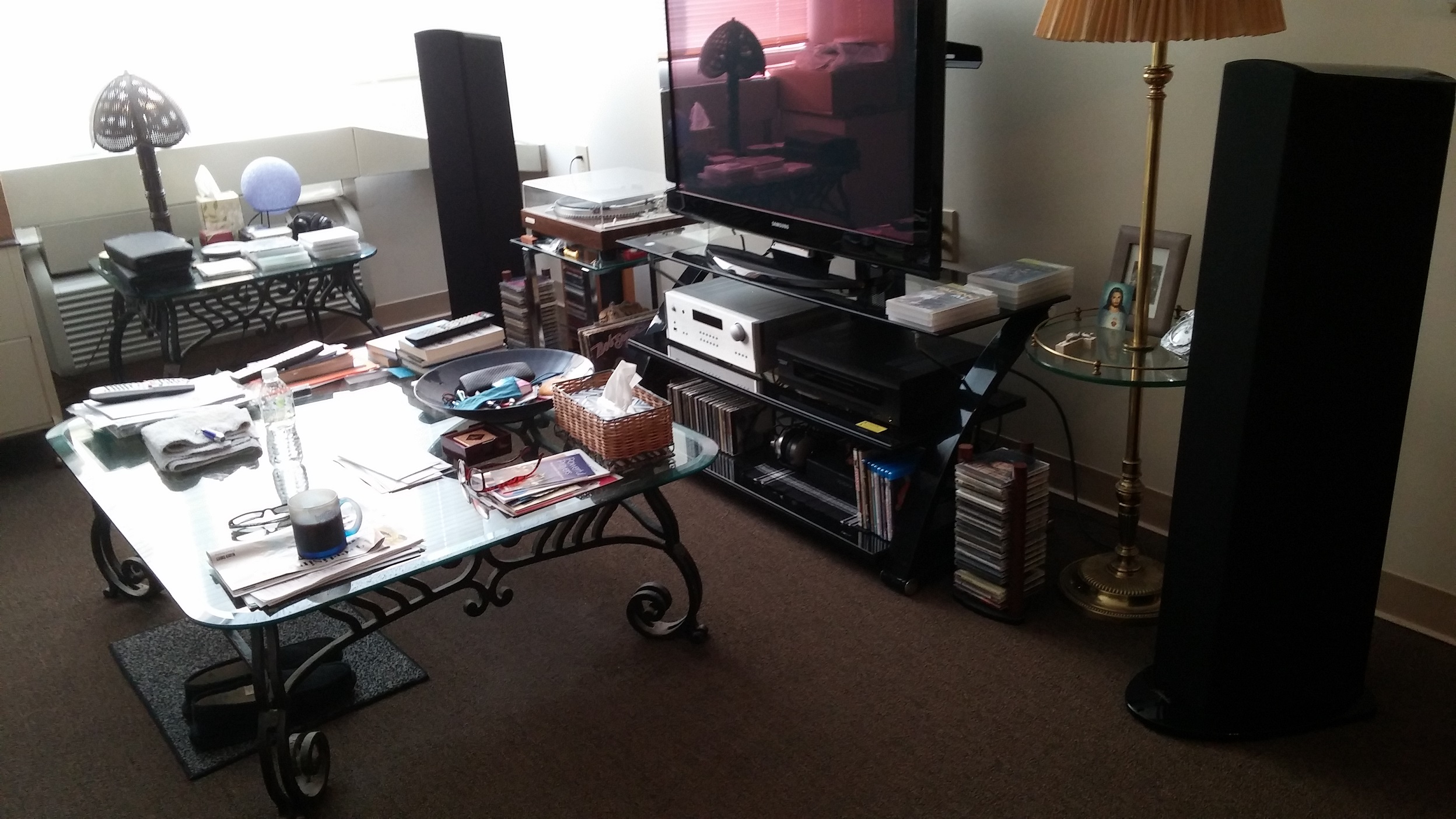

I've attached a photo of my listening area for your evaluation with request to my questions.
