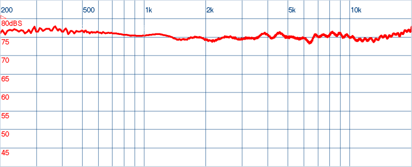

I like Flat, Accurate, Neutral speakers. For example, this is the published response of one of my speakers, the BMR.
And this is the same speaker, as tested by Shady for AH:
On the other hand, some people want their speakers to have elevated Lows, or nuanced Mids (whatever that might actually mean).
As long as you are able to work that out with your designer, then you should be good. :)
This flat line looks real sexy! This is exactly what I am aiming for. I really dislike sound colorization.. If the instruments don't sound natural I would rather not listen to them at all...
