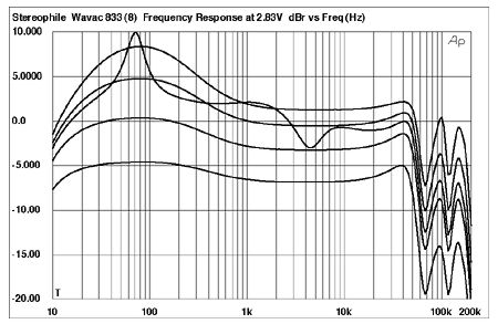

SET tube amps usually have very high output impedances(in the single digits!), causing severe frequency response devation at varying loads(manifested in the impedance variatons at the resonant peaks of the bass alignment and the load variaton around the crossover regiion(s). Here is the frequency response(beyond pathetic) of one of the world's most expensive amplifiers(Wavac SH-833):
http://www.stereophile.com/images/archivesart/WAVacFIG01.jpg
Stereophile text: Fig.1 Wavac SH-833, 8 ohm tap, frequency response at 2.83V into (from top to bottom at 80Hz): simulated loudspeaker load, 16 ohms, 8 ohms, 4 ohms, 2 ohms (1dB/vertical div.).
A 'little' more variable?
-Chris

djoxygen
WmAx said:
SET tube amps... severe frequency response devation at varying loads
I'd think one could do better than that with a tube if one really tried. Maybe the "warmth" doesn't just come from THD. That +5 at about 80 Hz might beef up the sound a little, eh? >;-)
