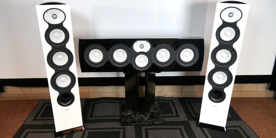

My recent experience with matching centres goes along the line that I was not able to use the same tower as centre (to tall to clear a flat panel display placing), and these brands did not have any horizontal centres that would be matching in any respect. Thus, had to match based on what @PENG has described. It worked pretty well both times. Good centre speaker with similar basic characteristics (FR response, dynamics, distortion, close enough crossovers and same number of them, etc.), to the LR will generally be a good match.
For anyone with big bad towers, I do wholeheartedly recommend Revel C426 centre. That speaker is truly amazing and best centre I even had - by far. Not sure if people can get advantage of this deal (Ebay Germany), but if they can, it will be worth every penny. I am not affiliated in any way with the seller nor endorse them, but did get my speaker from them (in EU) in perfect and absolutely new condition.
Oddball, do you use your C426 with or without the grill? My conundrum is that without the grill, I think the sound is better. The grill has vertical and horizontal components that, it seems to me, are major diffraction elements. But with the grills off, we get the full exposure to 4 white woofers, one white midrange and a white tweeter baffle. Sitting just below the TV, this is distracting.

Revel is a step above Klipsch IMO too.
In this case, I find it hard to agree. Though I don't have experience with the C426Be my experience is rather broad in general and I do own a full set of KL-650-THX's and they are truly amazing HT speakers.
In his case, since he had Revel LR speakers, matching the center was the right choice and should be the improvement he's saying it is.
Yeah, the KL-650-THX-Ultra2 has got to be among the most accurate speakers I've ever seen in terms of measurements. Never seen any Revels or other brands that accurate.
"The KL-650-THX's listening-window response (a five-point average of axial and +/–15-degree horizontal and vertical responses) measures +1.00/–0.87 dB from 200 Hz to 10 kHz."

I absolutely agree, that Klipsch THX is a great speaker. It was the matching that mattered. If I'd had three, I probably would have been very happy. The only problem with three of these big, ugly Klipsch boxes, in my case, was placement and SAF. Behind a transparent screen or built into a dedicated housing around a TV, I think they would be hard to beat for home theater. Music, I'm not so sure.

Klipsch are good speakers if you are looking for bookshelves and 80hz crossover, but as noted don't think current model. Revels we are comparing are bigger speakers that will reach lower and produce bigger and more dynamic sound for bigger rooms. While there is nothing wrong with having a bookshelf based HT system, it is not the same, or equally performing as having tower based HT system. However, it is also a matter of preference - some do prefer monitors to towers.
Audioholics reviews are pretty good for both, but seems like more enthusiastic for Revels.
"The C426Be center may well be one of the best performing center speakers on the market right now at any price. It looks fabulous, it is extremely accurate on and off-axis, it has good sensitivity with a reasonable electrical load, and it has an abundance of dynamic range."

Let me put it this way - Revel center is at least 3 steps above the Klipsch THX LCR.
That's actually a non-sensical statement. There's no such thing as a "step in audio"

No need to back up anything on my end. My personal opinion.
But the truth is, however it might be different to acknowledge for you, that Revel C426 center runs circles around the Klipsch. Perhaps this is the right audio translation instead of “steps”.
Gene has monstrous towers so really no need to speak to Gene as actions speaks more than words. Even Revel towers are not good enough for him, but again they do run circles around the Klipsch.
Except that it doesn't. There's absolutely no data to support that and, in fact, the Klipsch measures better.
Here's the C428Be (didn't find the C426) on an anechoic measurement
Here's the in-room
And here's the Klipsch
As do I. More than one pair in fact; and many dozens over the decades including such luminaries as the RS2s and 801Ds. I would really hate to imagine that you were on some post somewhere telling some bookshelf owner that I disagreed with their choice to go bookshelf based on the fact that I own monster towers. Then again, I would hate to imagine that you were attempting to speak on my behalf at all.
