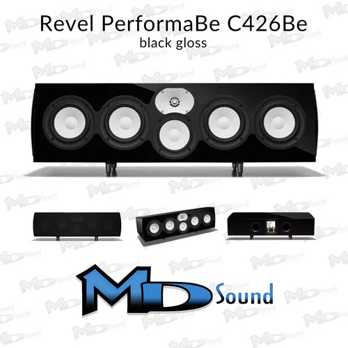

I recently replaced a Klipsch center (THX 550), with a Revel Performa C426Be center, which closely matches my left and right front channel speakers, Revel Performa 226Be.
I had thought that Dirac, implemented on my Marantz AV10, would compensate for the differences in the Klipsch center and the Revel left and right speakers.
But, no, the front soundstage is now seamless, and I now know it was NOT before making this replacement.
Maybe it's the higher quality of the replacement speaker, partly, but I think that the near identity of the present triumvirate is the thing.
Your thoughts?

I would say the beryllium tweeters matching helped tremendously.
I agree, the horizontal dispersion of these Revel Be tweeters and waveguide is exceptionally broad and even (see for example Erin's measurements of the 326Be). That, I'm sure, is not the case for the Klipsch.

Congrats on getting a truly great speaker. I got the same one a month or so ago and really love it. I don't have Revel towers to match, but got the center on basis of measurements and reviews as well as size. It turned out to be a really good match to my Heco La Diva towers. The front soundstage never sounded so good.

I wholeheartedly agree, this Revel C426BE is a truly excellent center channel. It's by far the best I've ever had, that's for sure. All of this Be Performa line seem to measure exceptionally well and sound excellent. I know mine all do! I don't believe that they developed much of a following however and am not even sure that they are still being made.
Timbre, to go to another point made above, is just another word for accurate frequency reproduction over a time envelope and I don't believe this is the major improvement that I made (I'm using Dirac full range).
I also agree that size matters, and your example is a good one. Dynamics especially, will be unbalanced, the the likelihood that timbre changes with volume unequally also comes into play, I would think.
