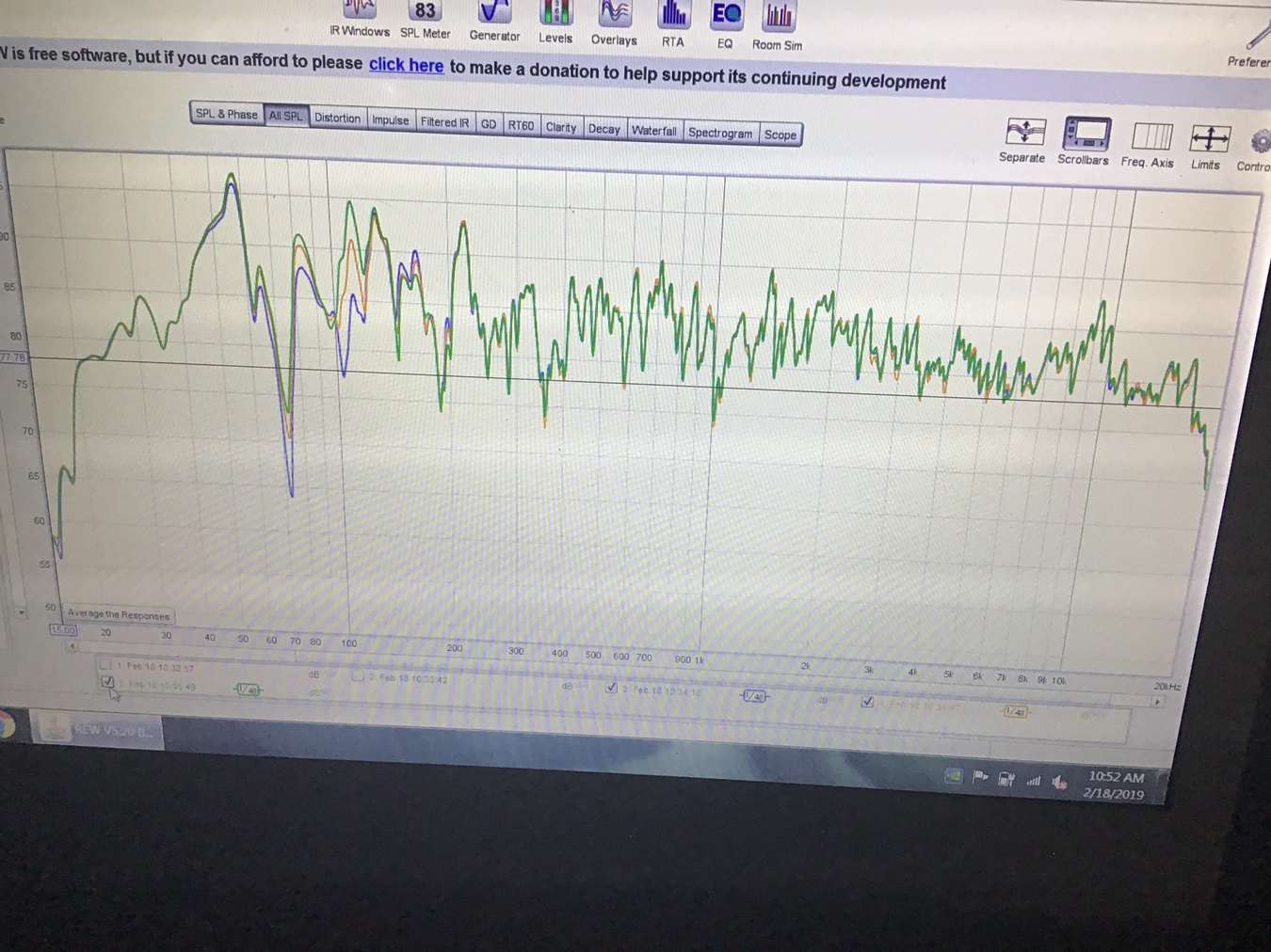

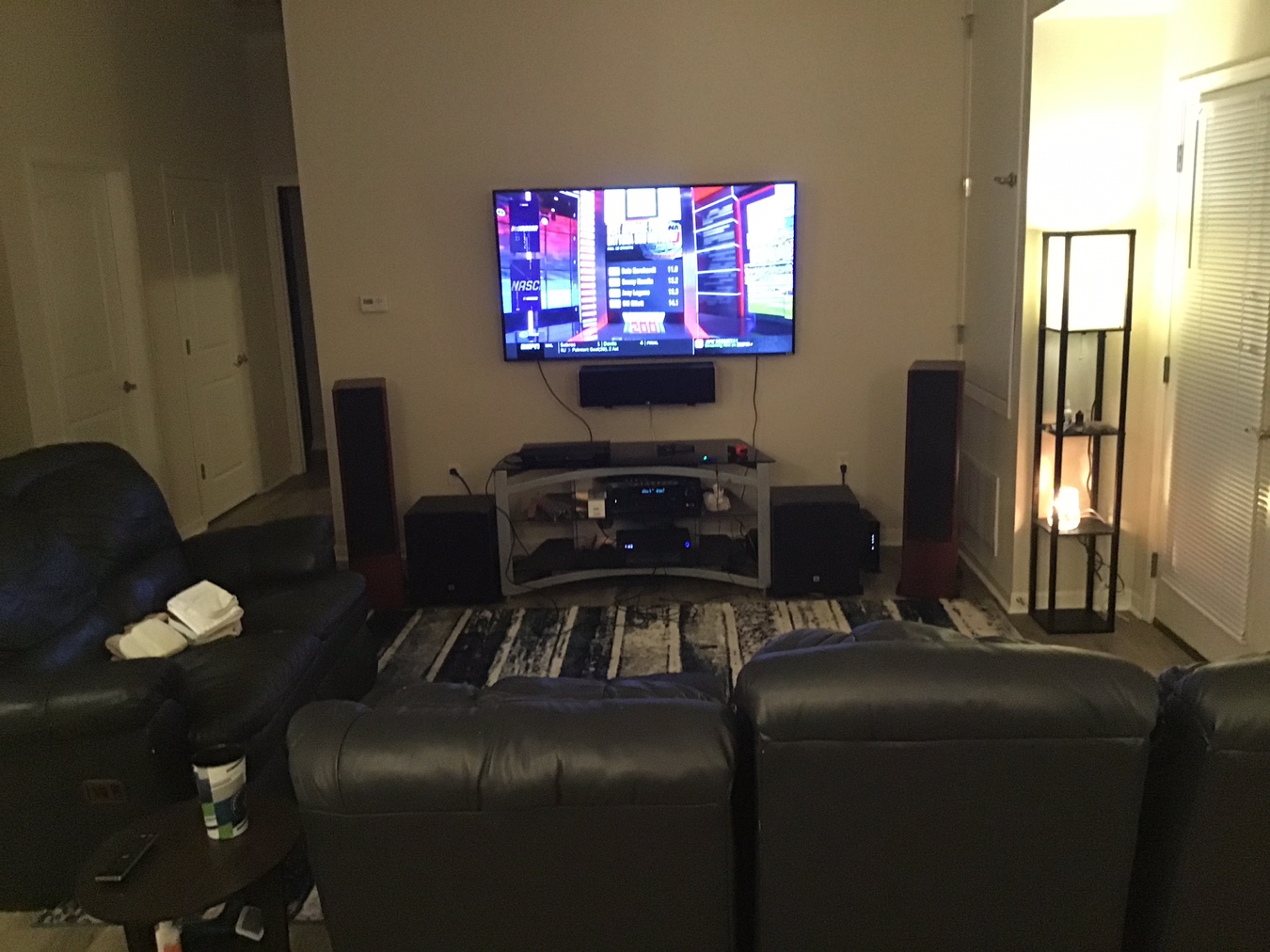

I have a massive dip in my new apartment. Depending on where I put the cross over it can be any where from a 10-20db dip between 40-80hz. I’m looking some forms promo treatment plans. I’ve added pictures of my room and of the FR graph.
The blue is crossover at 80, orange is at 100 green at 120.

I should also add that these measurements were taken at 85db and with Audyssey off

That 'massive dip' sure looks like floor bounce. Everyone with a floor has it. Don't worry about it, and any effort at correcting it runs the risk of 'sucking the life out of your speakers' (to use a technical term).
Try retesting after moving your microphone further away or closer to the speakers. If the frequency of that dip changes with microphone placement, that makes it certain it's floor bounce.

I did a lot of moving subs and then the mic and it got better when as I got closer to the speakers so that means floor bounce? Bs part is that the it got better 7 feet from speakers and that would look awful when I have a 17’ long living room being that close to the speakers lol

Symmetry with regards to subwoofer placement is most certainly not your friend. That dip is too low in frequency to be floor bounce. This is an axial room mode, because, with respect to the length of your room, the subs are in the same place. Move one of the subs to a different lengthwise distance placement in your room. Try a sidewall or rear wall placement, or maybe even a near-field placement.

On the response curve, the sub crossover is set at 80 Hz. How about an out of phase situation between subwoofers and main speakers?
Certainly possible and easy to put to a test. Compare measurements before & after switching the polarity of the sub woofer.
I have thought a lot about doing it but i read I shouldn’t because my avr (denon 1400h) needs the subs to be equidistant because it can’t calibrate them separately. Is there a way around that?
I did that this morning . The results were better with it at 0 the way it was for both of them

Get ready to upgrade your AVR... :p
Then, plug one in and calibrate. Note the level settings for it. Run calibration for the second placement, note calibration settings. Plug them both in and adjust manually to fit. I used audyssey to set my distance and levels, but otherwise have turned it off. If you can keep them somehat eqiditant from you, the delay will wash out. You can adjust gain to match on the sub. :)

I ran REW for 4 hours today. Did a lot of combination of things. Bottom line, having 2 subs up front is pointless because I’m getting almost the same response from one being up there alone ( right was better). But idk how I can make this work when the information tells me I need a avr with xt 32 for my subs to be anywhere but equidistance. That’s my situation. Thanks for the replies and help I just feel like I wasn’t being clear enough.
Then, plug one in and calibrate. Note the level settings for it. Run calibration for the second placement, note calibration settings. Plug them both in and adjust manually to fit. I used audyssey to set my distance and levels, but otherwise have turned it off. If you can keep them somehat eqiditant from you, the delay will wash out. You can adjust gain to match on the sub. :)[/QUOTThats a good idea, but how will that work if in levels and sdistance my avr treats the 2 subs as one
That’s very clever Ryan but how can I enter them but I can’t enter 2 values for subs my avr treats them as one

REW with minidsp would allow you to do that, I believe.
The takeaway today was as I moved my couch forward the dip lessened . But I cannot sit 6-7 ft away from the tv and have 11 ft behind me. Also I kept one sub flanking the CC to one side for every measurement and moved the 2nd around and it seemed to make little to a small difference in the results. Today was discouraging because I tried putting the 2nd sub several places and it didn’t change much. The true change was being 6 feet from the tv lol. The dip went from -20 9.5 ft away to -2 6 feet away
