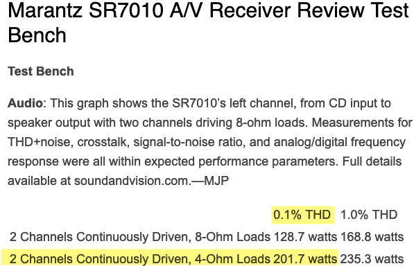

The measured avg SPL , is in my room with a pair of MartinLogan 35XTs in 2 channel music setup with Marantz SR7010..,and these existing speakers infact measured 89 dB sensitivity , lower than the Focals.
The audition in store (room treated) is also with Marantz AVR (SR6014).
The power requirements are based on dB SPL( 75 dB avg, 95 db Peak), Speaker sensitivity(89.5 dB), MLP ( 11ft), #Speakers(2) , Speaker placement.
So how will, swapping the ML bookshelves with a pair of Focal or ML towers , going to change the avg SPL requirement of 75 dB/95 db peak ?.
Even if I were to double the power requirement(+ 3db), its 40w and double again , 80W. I dont listen to listen anything louder than this..certainly not at reference levels.
Like I posted earlier, SR7010 is a top of the line Marantz AVR , that was in my HT , for 5 years now , playing MOVIES LOUD with my Focal 826V, with even lower sensitivity.
Or are you guys saying 201w with 2 channels driven into 4 Ohm load , is not clean power at 0.1% THD !?
I standby this , unless you guys convince me otherwise ;-)

Its not the Wattage that is of concern with the Focals... it's the current required to drive them. Marantz Amps are rated to 4 Ohms, but with a 2.8 minimum in Impedance, you need a more robust Amplifier to safely drive speakers like those, many Polks, B&Ws, etc.
That is what gives speakers like these a reputation for being "power hungry" and thus called "amp busters." But its not the wattage rating of the amp that matters. Rather, stability below 4 ohms!
I might be mistaken in this, and will gladly accept the correction if I am!
True, but Power(wattage) & Current(amp) are not independent.
For DC circuits,
Power(P)=Voltage(V) * Current (I); where Voltage = Current(I) * Resistance(R)
So Power=Isq * R and so I = √P/R
and for AC circuits, phase angle comes into play
Real Power P = IsqR cos(Φ) = V*I*cos(Φ)
We know the Power(~200W at 4 Ohm load) and the minimum impedence(2.8 Ohms), measured at 108hz and phase angle of ~67?. How much current do we need to drive this speaker ?
@PENG , can you chime in pls ..
First of all, since you are talking like someone knowledgeable in EE, I would add that for ac circuits,
P = V*I*cos(Φ)*Distortion factor, that's just for tease, practically speaking we can mostly ignore the distortion factor that people rarely mentioned anyway.
So you have the formula but there is no simple answer because impedance (a phasor that has magnitude and phase angle) varies with frequency. Take a look of the graphs below and you can see how you can determine the current and power (in watts) on a point by point (frequency) basis.
For current, at a given voltage you can simply pick the lowest impedance magnitude point.
If the BMR is used as an example, it appears to be about 5.5 ohm at around 1,600 Hz. No idea why it would be lower than the woofer's minimum impedance, perhaps from cemf? (would need to do some digging..)
So you can find the current using just Ohm's law:
At 28.3 V (just an example), I = 28.3/5.5 = 5.15 A that's rms, peak would be 2X5.15 = 10.3 A.
The phase angle at that point was near 0 degrees so totally negligible. Suffice to say, the BMR can be considered easy to drive. It's sensitivity is on the low side, but still, something like the 3000 series Denon AVR should be able to do a good job for a lot of people.
If it were say 60 degrees, then it would be bad, because cos (60) = 0.5. It however, does not mean the calculated current drawn by speaker will be higher because of the 60 degrees phase angle. What it does mean, is that the "real power" (watts) consumed/dissipated by the speaker would be half of that of if the angle was 0 degree, and that means the power amplifiers output transistors would have to dissipate much more heat at high phase angles.

That's why I think it is better for manufacturers to use voltage and current instead of power in watts.
Use of watts is, imo, the mean reasons why there are so much confusions and misconceptions perpetuated by hearsay on the internet.
For a worked example, it is best you read it yourself in the article linked below:
Thanks for your inputs!
No I'm not EE, but I do have some understanding of how electrons move through the circuits and the functions of the different components(resistors,capacitors,transistors etc) ;-) , from a 4yr degree couple of decades ago, focussing primarily on Computers/IT.
Back to the topic , yes the impedence varies by frequency and for the Speaker in question(ie Focal Aria 936), that I posted earlier in the thread, the lowest impedence is 2.8ohms at 108Hz ..where the phase angle dips to around say 66 , as you can see below from the Stereophile measurement..
So Power factor = cos(phase angle) = cos(66) = ~0.4
and per Ohm's law & I = √P/R , for 201.7W into 4 Ohm load (from Marantz SR7010 S&V test bench) , I get Voltage of 28.4V and Current of 7.1A.
For the worst phase angle of 66, the impedence is 2.8 Ohms , I = V/R= 28.4/2.8 =10.1A rms and 20.2A peak.
So Real Power P= Vrms * Irms * PowerFactor = 28.4 * 10.1 * 0.4 = 114.7 W (assuming the Voltage rms stays in that ~28v region).
so yeah , the real power is reduced drastically at high phase angles..The peak power(load) is reduced to as much as 0.24.
I think I know the answer, but the outstanding question still is..,wont the Marantz SR7010 be sufficient to drive a pair of Focal Aria 836s in a 2 channel music setup with couple of cooling fans running, listening well below reference levels ..,with all things, listed above, factored :)

I think you read the graphs wrong. Phase angle is the dashed _ _ _line, it seemed more like -20 degrees, cos (20) = 0.939, not a problem at all.., though the 936 is still a tough load for the range of 70-850 Hz.
duh! ofcourse..problem with multi-tasking between "paid-work" and "hobby" in the middle of work-day!
I'll take the power-factor of 0.94 ANYTIME ...I dont loose much power at all, at the worst phase angle..smooth sailing there.
Now at 70-80hz, yes I do see the high phase angle , but atleast the impedence drop is not as low as 2.8 in that region..more like 6-4ohms ..and so the power factor is not that bad and still within operating parameters.
... makes me feel better , with actual numbers.

The SR7010 may be able to handle those speakers, but that impedance and phase would put a serious strain on all but the highest end AVRs. It will be pulling a whole lot of current through the amp at a heavily used frequency range.
Agreed, but if he is serious about needing only 75 dB from 11 ft he would be fine with the SR7011. I actually find 75 dB average C slow is more than loud enough for me. If I were to use the SR7011 with any 4 ohm nominal speakers, especially when the phase angles aren't great, I would put a couple of fans on top anyway. The AVR can handle the load but it would run too warm for it to last too long imo.:D
You #$@#( ;-) Dont curse pls...bless it instead!
( Its 8Ohm nominal impedence rated, but yes drops down to 4-2.8range.., )
