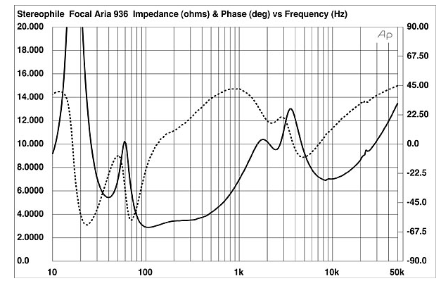

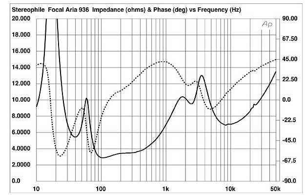

The Aria 936s have a reputation for having a bit of excess in the midbass, which may give the impression that they go lower than they actually do.
You can see from these measurements that the bass hump is larger than in most of his other measurements. (There is usually a hump due to his measurement technique. But this hump is larger than most.)
https://www.stereophile.com/content/focal-aria-936-loudspeaker-measurements
You're referring to this assessment of the reviewer ?
"A large part of the upper-bass peak apparent in this graph will be due to the inevitable exaggeration of the nearfield measurement technique. But with the overlap between the outputs of the three woofers and the midrange drive-unit in the same region, it is hard to escape the conclusion that the Aria 936 will have too much upper-bass energy in all but very large rooms. I note that Bob Deutsch found that the Focal's bass sounded extended, but without the low frequencies sounding "boomy or bloated," which suggests that the woofer alignment is on the overdamped side. Though the tuning frequencies of the ports bracket 40Hz, close to the frequency of the lowest string of the electric bass and double bass, RD did comment on the Aria 936's excellent low-frequency extension; I suspect that this is actually related to the speaker's exaggerated upper bass. "
Yeah, with 3 woofers & midrange driver in the same region , am not too surprised on the exaggerated bass. It didnt really show up in my auditioning with different tracks though..very natural and not too pronounced like the 60XT.

The impedance and electrical phase of the mid bass and upper bass make this a tough load for amps. I would not run these speakers on any AVR. A robust outboard amplifier is pretty much a requirement for those speakers.

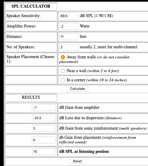

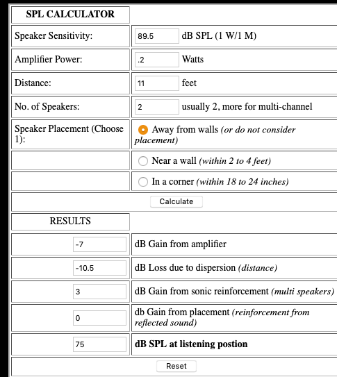

from the Peak SPL Calculator , I get 0.2W requirement to hit my average listening level (75db) , with Aria 936's measured sensitivity of 89.5 dB (Focal rates them at 92dB) at 11ft listening position for 2 channels.
Allowing for a 20db peaks , over average , I get 20W power requirement.
Still planning to use my current AVR Marantz SR7010 to drive the 2 channels ( things could change in future).

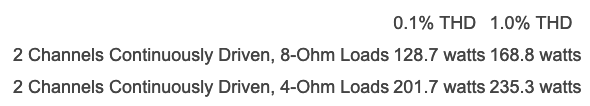

They measure well for 2 channels Marantz SR7010 S&V measurements

Hi, can you elaborate this pls..
SPL is achieved, but most AVRs cant handle very low impedance (especially at certain frequencies), and combined with phase angle it can put a real strain on the amp sec8.
So 936 is rated 8 Ohms nominal impedence & 2.8 Ohms minimum impedence..confirmed by the measurements
You think the SR7010 cant handle it , given the posted S&V test bench results of the aVR ?
The SR7010 may be able to handle those speakers, but that impedance and phase would put a serious strain on all but the highest end AVRs. It will be pulling a whole lot of current through the amp at a heavily used frequency range.

At lower volume yes, but I still would have a more robust amp for them.
So like posted earlier, at 75db average & 95 dB peak, need only 20W , which is very well within the comfort zone of this AVR.
Doubling that , still puts the power requirement at 40W.
Do you have a SPL meter or phone app for one? If so next time you listen to the system you have back the seat to MLP and see what low is for you.

The measured avg SPL , is in my room with a pair of MartinLogan 35XTs in 2 channel music setup with Marantz SR7010..,and these existing speakers infact measured 89 dB sensitivity , lower than the Focals.
The audition in store (room treated) is also with Marantz AVR (SR6014).
The power requirements are based on dB SPL( 75 dB avg, 95 db Peak), Speaker sensitivity(89.5 dB), MLP ( 11ft), #Speakers(2) , Speaker placement.
So how will, swapping the ML bookshelves with a pair of Focal or ML towers , going to change the avg SPL requirement of 75 dB/95 db peak ?.
Even if I were to double the power requirement(+ 3db), its 40w and double again , 80W. I dont listen to listen anything louder than this..certainly not at reference levels.
Like I posted earlier, SR7010 is a top of the line Marantz AVR , that was in my HT , for 5 years now , playing MOVIES LOUD with my Focal 826V, with even lower sensitivity.
Or are you guys saying 201w with 2 channels driven into 4 Ohm load , is not clean power at 0.1% THD !?
I standby this , unless you guys convince me otherwise ;-)
