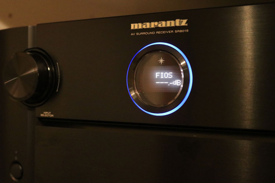

The Marantz SR8015 is king of the hill as far as 11CH AV receivers go. This 11.2CH Atmos/DTS:X Pro HDMI 2.1 AV receiver is built on a very solid platform with benchmark measured performance while offering new features including:
  • Preamp mode
  • DTS:X Pro
  • HDMI 2.1 with 8K support
  • 13CH of processing
  • Dual speaker presets
  • eARC for high resolution audio streaming and so much more.
Best of all, the SR8015 is a wonderful sounding, high performance one box separates-like solution that will satiate the audiophile, home theater enthusiast and gamer alike (thanks to low latency mode). Best AV receiver for 2020?
Read: Marantz SR8015 Review

Thank you Gene for the review. Looks like the SR8015 is a very nice unit. But to answer the question as the Best AV Receiver for 2020? I would say no. That belongs to the Denon X8500:
-Measures better than the SR8015
-X8500 has the ability to process and amplify 13 channels
-X8500 has the ability to individually disconnect channels offering the best of both worlds in terms of performance and flexibility
-SR8015 Slow filter and no ability to change it to a more standard filter
-Aestetically and functonally, can we move on from the tiny portole display. Denon is much more functional. It is time for both to embrace something better like a tft touch display or something similiar like many brands are offering.
Thanks again for your review and nice to see Marantz continuing to make improvements.

Hard to compare when the measurements are now so close between the two, the video makes it more difficult too, or I am just too lazy to keep pressing the pause button and take screenshots. For a technical review, I prefer the non video style.:)
snakeeyes
Great review!!!
Only a couple comments on best AVR. First I’m not a fan of removing center spread from DSU either (2nd set of AVR settings for music listening with center down 6dB may mitigate that and Dolby is to blame, not Marantz).
I’m also not impressed with the idea of having to use the TV for 8K HDMI switching and eARC for audio to AVR. (Single 8K HDMI Port is the reason). The 2nd issue is the concern at this price point. This probably could push some buyers to wait for the next model. I also hear the Yamahas coming out this year will support several 8k HDMI ports so this functionality is just around the corner it would seem.
DJ7675
Hard to compare when the measurements are now so closed, the video makes it more difficult too, or I am just too lazy to keep pressing the pause button and take screenshots. For a technical review, I prefer the non video style.:)
Very true, I was also referring to the 2V measurement provided at ASR which shows 99 (still really good!). With the Denon at 103 or so. In addition it always seems that Denon/Marantz measurements are always 1-2dB better than both there as well as at Audioholics (not that that is significant). Not meant to take anything away from the SR8015 as it looks like a great option as well and much improved over the SR8012.
EDIT: You are correct of course it is difficult to compare between slight differences in measurements at ASR/Audioholics/Directly from Denon/Marantz.
