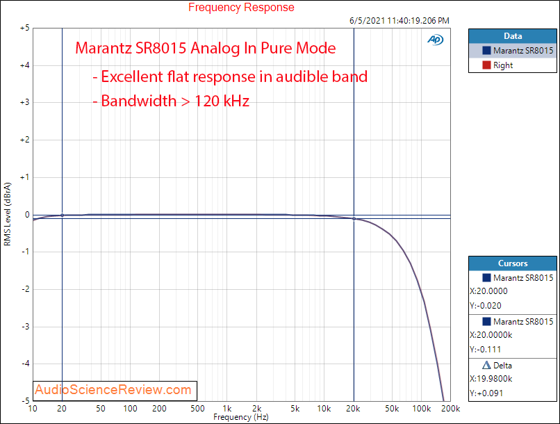

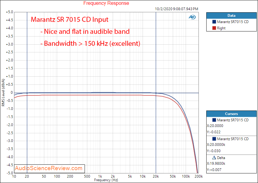

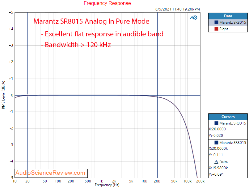

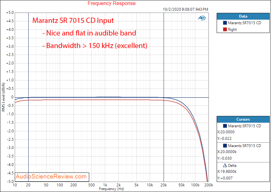

I'm not seeing that in these frequency responses, If anything some of there models drop sharply at 20khz during the same model year as the op.
Marantz SR7015 Home Theater AVR Amplifiers CD Frequency Response Measurements.png
View attachment 59542View attachment 59543

I wasn't implying that it was skewed just that it has been measured as I described with sharp roll off at 20khz with a couple of their models and via a couple of inputs.
