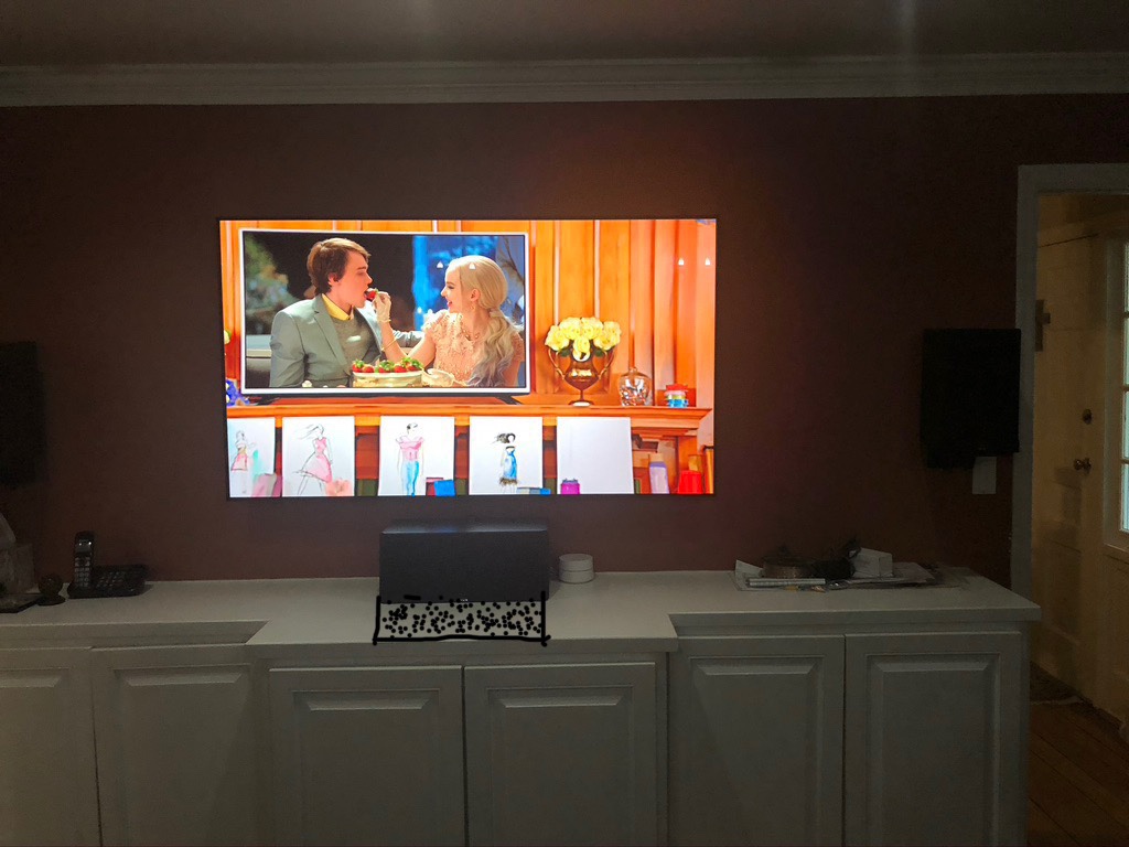

One of the bigger take-aways from Shady's article on Speaker Grilles: On Or Off? had to do with speaker placement being a much more impactful variable on sound quality rather than whether you used grilles or not. IIRC, your placement had that entire cabinet surface top in front of your center channel. Soundwaves are coming out and some are bouncing off the baffle of the speaker itself: this is common and good speaker designers account for this in the XO designs. Longer waves come out from the drivers and should radiate freely into the space around them. What you have is a significant boundary where (lets arbitrarily assign 40% just to help illustrate the issue) 40% of the soundwaves from your center speaker are being forced up and away from your listening position. Some of these may interact destructively with other soundwaves emanating from your Center creating cancellations, while others are sent bouncing haphazardly around the room.
Simply tipping the speaker up an an angle, say, or elevating it completely above that surface may or may not change anything. The better strategy is to have the front baffle sticking out just a little bit in front of the cabinets, and doing so in a way that has the speaker aimed more directly at your LP. The best strategy is to have the Center on its own stand which will allow it room behind (assuming it's ported) and room all around such that the speaker will perform as designed, radiating soundwaves naturally into your room and directed at you.

Personally, if it was me, I would try sliding the speaker forward before pricing a new one.
1) it's free
2) it's easy
3) it will almost certainly improve things

What if I prop up the center instead of pulling all the way to the end of cabinet?
Guess I missed this...
Anyway, I doubt that would do anything. In fact it might be worse. By propping up the front of the speaker, the distance between the tweeter and cabinet will increase and possibly just add to the diffraction and delay times. Higher frequency waves are effected by inches because they’re so short where bass waves for example are so long it usually takes at least a foot(ime) to see anything appreciable.
So if the speaker has to be back a little bit, I would try a plush blanket, or some acoustic absorbing material in front of the center. it wouldn’t take much time to lay down a thickish blanket to see if it helps. Might turn of audyssey for the experiment since that CC is EQ’d for its current installation.
FWIW, all the way to the front is still the best solution. If the cable is too short you can use wire nuts, or butt connectors. Then you can run a whole new cable layer if that’s bugging you.
