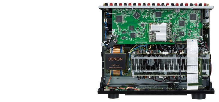

As a diyer, it is easier to buy a good quality audio grade toroid, but probably not an E-I, at least I am not aware of a good source. Sony had pulled a fast one at one time when they stuffed the DA4 ES and lower models with Bando's. Otherwise they used their custom made ones that had the ES label on them. Those Bando tx were of decent quality (hum was quite audible though) but Denon, Marantz and Yamaha's were supposedly custom designed/wound to their specs and the are practically hum free, almost silent.
Those who use the generic ones (probably like Hammond's) looked ugly at best, iirc, the lower NAD AVRs have some ugly looking ones, no visible copper wraps to help reduced leakage flux for example.
