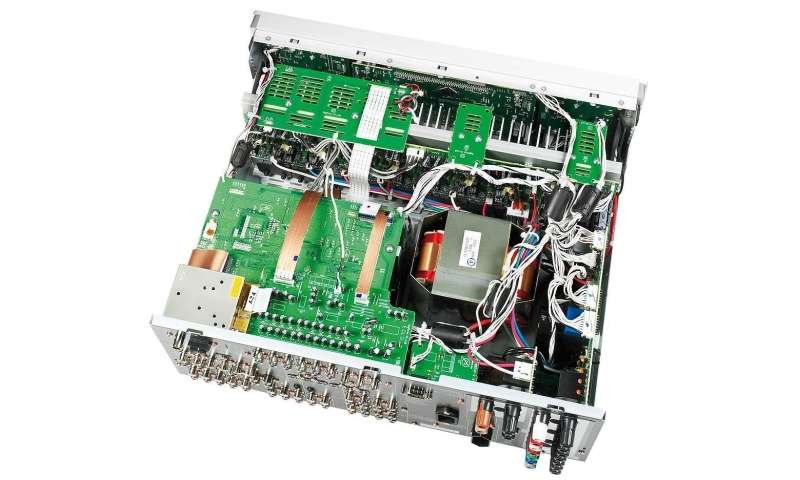

I was off on the model number, it was 6001 and 7001!
The translation (Google) isn't perfect, but ...
The SR 6001 differs externally from its 400 Euro brother 7001 only by a minuteness: The logo gallery on its front panel lacks the THX logo. Great. This saves ink, but above all royalties and sound means no disadvantage.
© archive
The powerful Marantz transformer loosens a kilowatt at multi-channel full load.
Two HDMI inputs instead of four, with slightly fewer inputs and outputs - the other savings will only ever be noticed by operators of extremely complex systems. To make matters worse, the 6001 delivered identical performance values in the lab as the 7001 - Marantz has apparently only deleted what nobody needs before.

For Denon/Marantz, this is still happening as recent as 2017. I am quite sure right up to 2019 as well but I have only seen the schematics for some of their 2016/2017 models.
For example, the Denon AVR-X4400H, Marantz SR6012 and SR7012 have the same schematics for their 4Ch and 5 Ch amp sections, with the same output devices, and even the voltage adjustments for the rails are identical to the decimal point. According to the specifications, the SR6012 do have higher THD, I bet it will measure just as good as the 4400 and 7012 on the bench. They do have slightly larger power supplies for the 4400 and 7012, but that's about it.
Recent Yamaha's are not available for free download, at least I couldn't find them, but I can tell you the older RX-A2030, A3030 and A2060 also share the same schematic and parts for their power amp section so by extension, the A3060 probably has the same amp section as the A2060 too.
