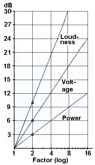

Frequency response is measured in frequency and it's loudness measured in dB - this is logarithmic scale = for example extra 10db means it's twice louder.
You are talking about psychoacoustic metrics which aren't as well-founded. For example, for a lot of people, when you increase the dB SPL by 10 dB, they can perceive that as a doubling of loudness, but not at all frequencies and not at all amplitude ranges and not by all people. Another strange fact is that if you turn down the amplitude by 6 dB, that is most often perceived to be a halving of loudness, but again it depends on circumstances. Personally, when I turn up the gain by 10 dB, that sounds to me like substantially more than a doubling of output.
But that all is discussing 'loudness' which, like I said, is a psychoacoustic metric, which uses a log base of 2. Amplitude, which is a more firm physical metric, has a log base of 10, so to double an amplitude quantity we increase it by 6 dB. But amplitude is not actual sound power, which has a log base of 20 where it takes an increase of 3 dB to double the power. This is why if you double the electrical power that you are sending to a speaker that only nets a 3 dB gain in output. What is interesting is the difference between the amount of actual physical power intensity and psychoacoustic loudness that we hear; it's a huge gap.
However, what we typically think of in differences physical energy really goes to amplitude. For example, if you double the volumetric area that a cone moves in for a certain frequency, you end up with a 6 dB gain in output. In other words, double the excursion for the same frequency results in a doubling of amplitude, although that also means a quadrupling of power intensity.
Here is a chart that illustrates the differences (keep in mind that voltage here means acoustic amplitude):
Oh and yes, a VTF-3 mk5 will vastly outperform any Rel subwoofer in lower frequency output.
