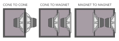

I have the understanding that isobaric and push-pull are two completely different things. You can have push-pull drivers mounted on the same face of the cabinet, even. Isobaric builds require a very tight sealed chamber between the drivers, and the drivers can be in the same orientation or clamshell… but the key is that the space between them is sealed. Dual-opposed is just two drivers firing outwards, but rather than being on a single front baffle, they are on opposite sides.
This is correct. Push-pull has nothing to do with where the drivers are mounted with respect to each other. It is merely reverse mounting one of the drivers while inverting its phase from the amplifier. This is done to use the air volume inside the sealed cabinet to modulate the driver's effects on each other. There is some discussion of the push-pull mechanics in the discussion thread for the Perlisten D215s.

The advantage of having an isobaric design in a push-pull configuration, is that it provides a better cone excursion linearity and contributes to a lower distortion.

A real push-pull arrangement is where the drivers are disposed 180° apart. This means, either the two cones or the magnets are facing each other:
View attachment 52106View attachment 52107
