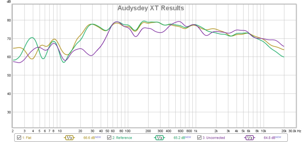

I already have a mic. Believe it or not the Audyssey mic is extremely accurate (+-2dB as tested on avsforum), and I purchased a second through amazon just for the purpose of taking rew measurements awhile back, and it works very well. I am already familiar with REW. While I could simply eq the bass, I did notice a lot of benefits using Audyssey full range for my main theater. The correction in the time domain really makes a big difference compared to simply EQing, as I’ve experimented with EQ using REW and equalizer APO with a pc hooked to my avr.
In my main theater room, the uncorrected response is fairly flat above 200hz
If you look at the response of the Audyssey flat curve, vs the uncorrected curve, the difference is extremely small, yet for whatever reason, I notice a massive difference with Audyssey flat enabled vs off.
Even with correction, I probably need to place some room treatment in the bedroom. The slap echo is horrible and I notice in my well treated main room I have significantly tighter imaging vs the bedroom, which is a blurry mess.
