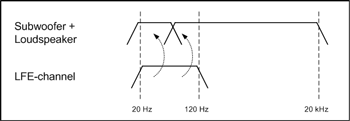

I would not try the lfe +mains unless your mains are very capable in bass. Unfortunately yours are not. 120hz XO point is probably good. Here’s a visual representation of what we’re talking about.
