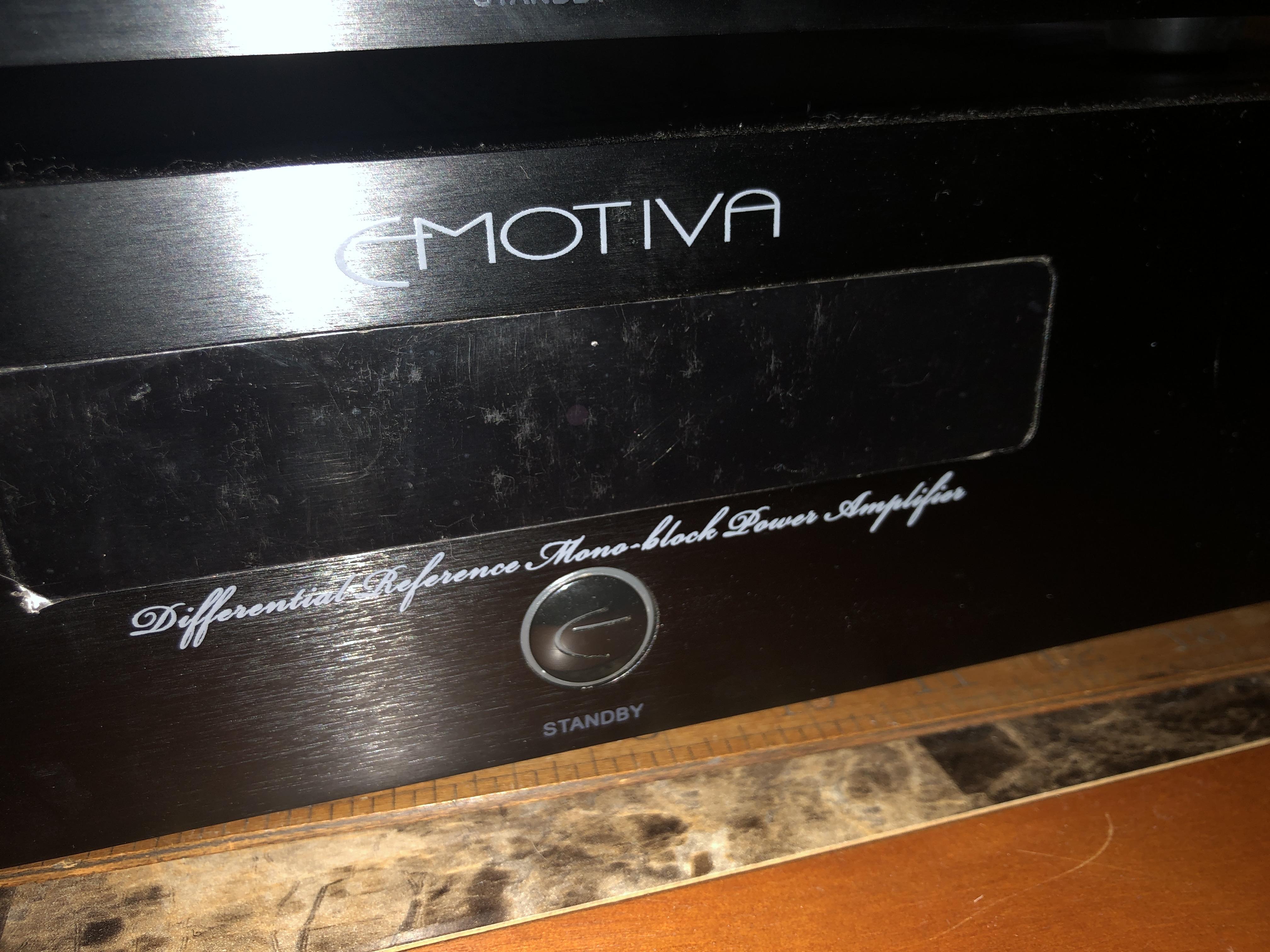

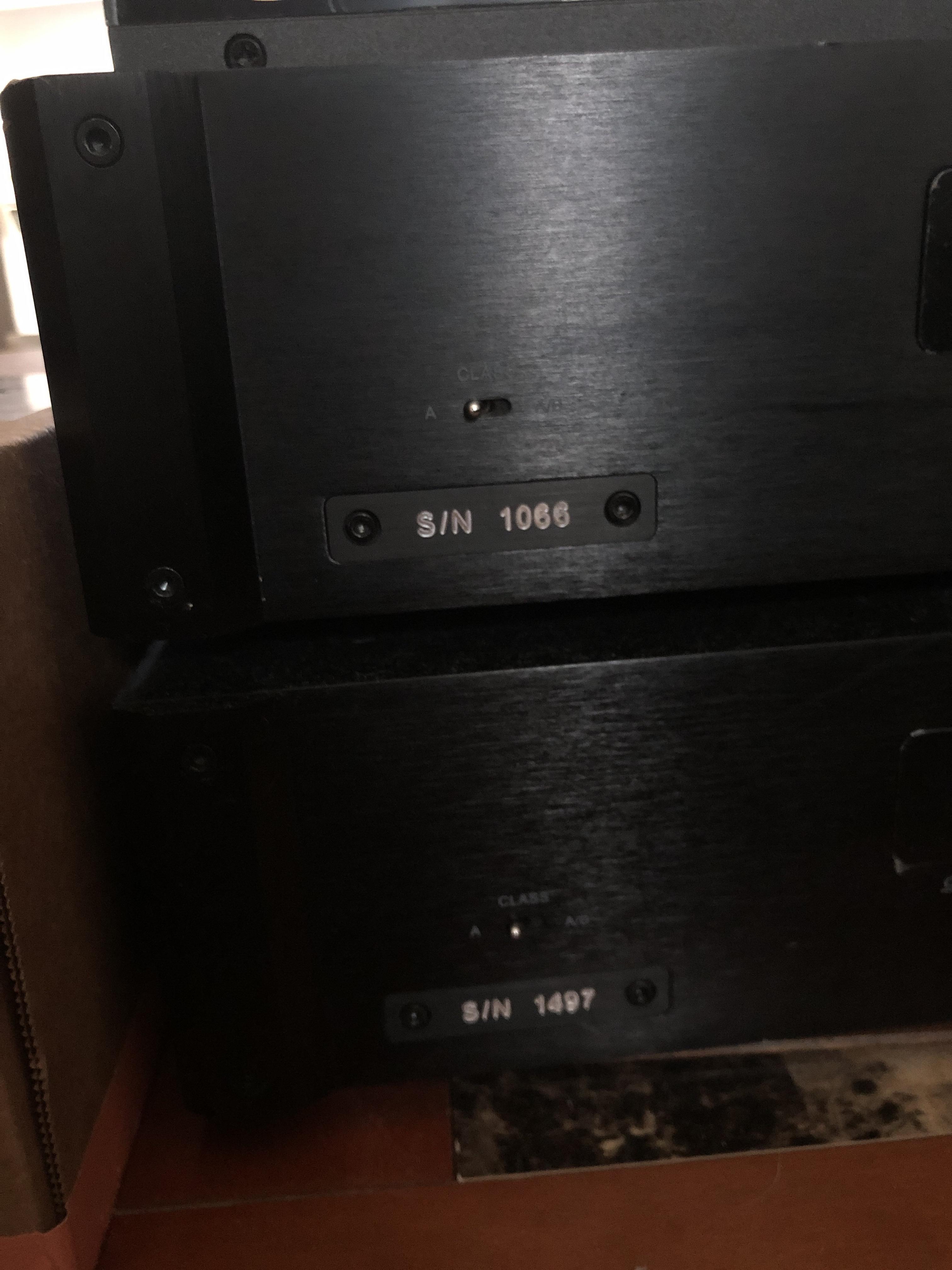

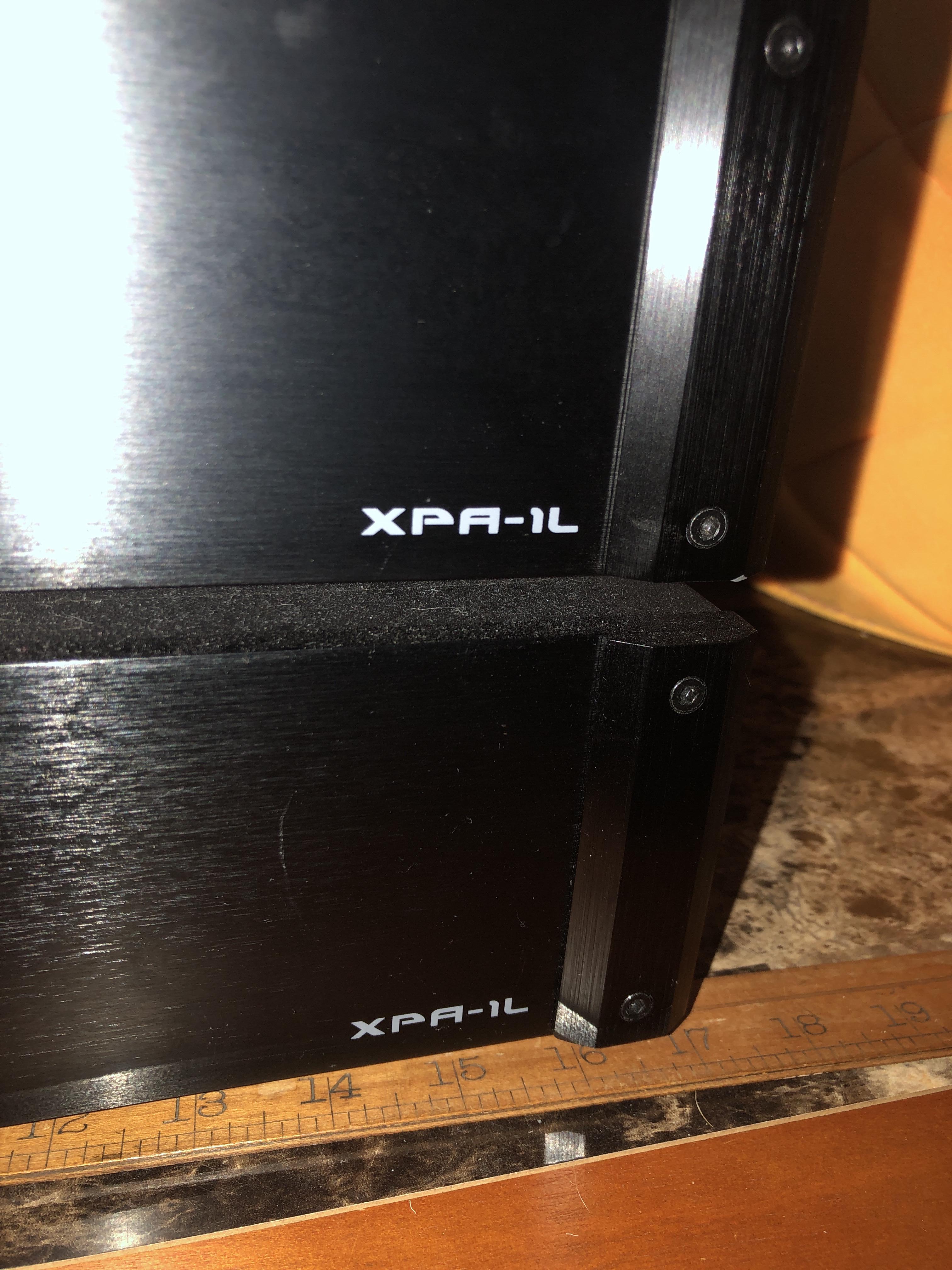

I have some mono blocks from Emotiva XPA-1L Gen 2 Monoblock Amplifiers, limited edition models with serial number badges on the front left of each amplifier
I may sell them as I just bought them a few months ago and still have not hooked them up. PM me if these are something that would work for you

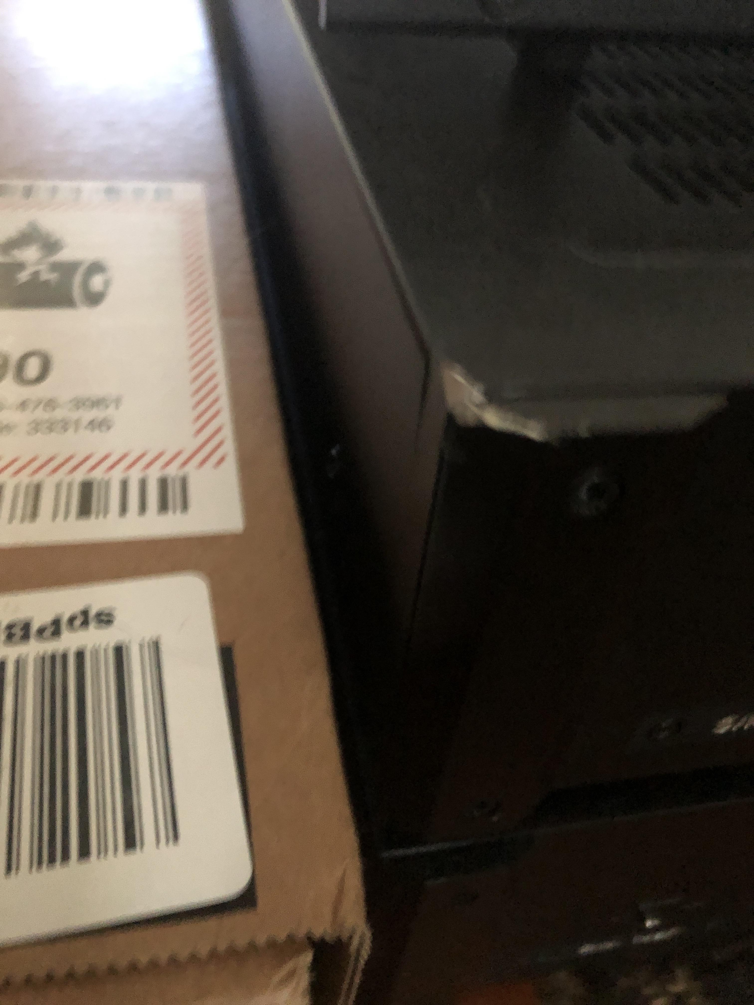

One of the got banged up in shipping, but it’s only cosmetic
