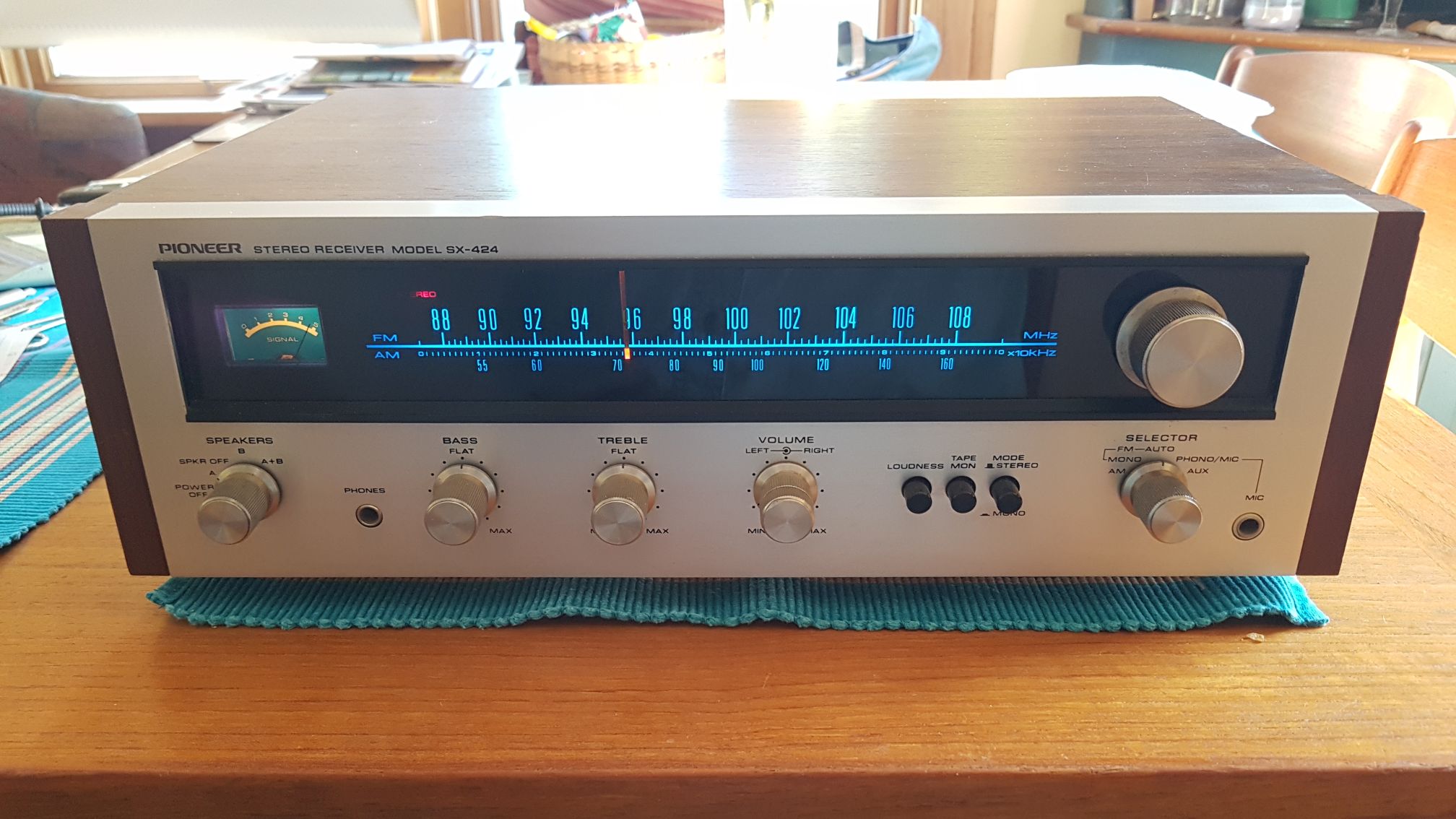

Yeah, I see recapped gear all over the marketplace and I don't get it either. I just restored my wife's Pioneer SX-424 and all it needed were LED lamps to replace the fuse style lamps in the display, a new stereo indicator lamp and new power cord. None of the caps are bulging and it works and sounds fine. Hooked it up to a pair of vintage KEF 103.2 reference speakers and sounded pretty damn good for only 12W per channel, but I'm not shaking any walls with this one. Would be fine for a small apartment or den though. They sold for $200 new and now sell for $250. :D I've seen people ask $400 for mint condition ones. Pretty sure I'll be able to get $200 for it. Cleaned up real nice and the LED lamps bring out the blue in the display.
Did it come with the speaker terminal plugs? That's a bit of a problem for that series. I had an SX-525 and bought a second pair of the plugs because I wanted to connect a second pair of speakers. Never had a problem with it.
Hell yeah, we have TWO sets of speaker plugs. ;) Those plugs alone are selling for $20 - $40 a pair. This was my wife's old receiver when we first started dating. Went into storage when I was given an early Kenwood AVR with surround channels.
