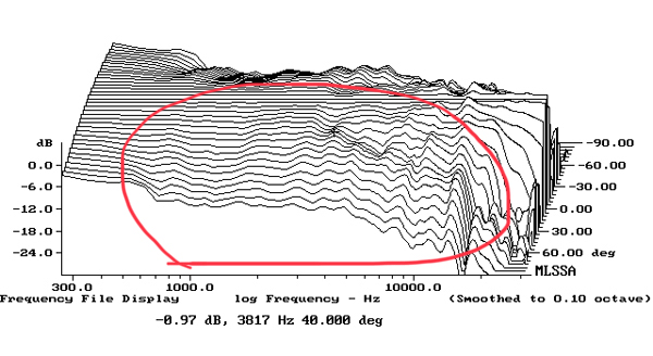

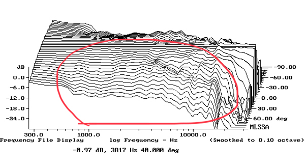

If a speaker has a high directivity index, that means that it is highly directional. A very narrow dispersion speaker would have this property, such as a very narrow horn-loaded speaker or a planar speaker. A speaker with low directivity has a wide dispersion pattern. Small speakers tend to have a wide dispersion. A true omnipolar speaker would be have a zero level directivity index all long the frequency response. Most speaker's directivity indexes vary along their frequency response. For example, this speaker:
The lower dotted black line is the directivity index that we are talking about here. You can see from its directivity index that it has a fairly wide dispersion up to 5 kHz or so, and then it begins to narrow. At 20 kHz, it is beaming pretty significantly, so you would have to be close to its direct axis in order to hear 20 kHz output at all from this speaker (btw, very few of us can still hear 20 kHz, so that is not a big deal). We can see this behavior more explicitly in the polar response graph:
We see a nice, smooth, even wide dispersion that begins to narrow above 5 kHz. To hear 20 kHz on this speaker, you would need to be within 20 degrees of its direct axis (assuming you could hear that high in the first place). Many conventional speakers act like this: low directivity in bass, where the speaker is almost omnipolar, wide dispersion in mids, and tightening dispersion in the highs. That isn't a perfect respones but it isn't a bad response either. Most people would quite like this speaker.
