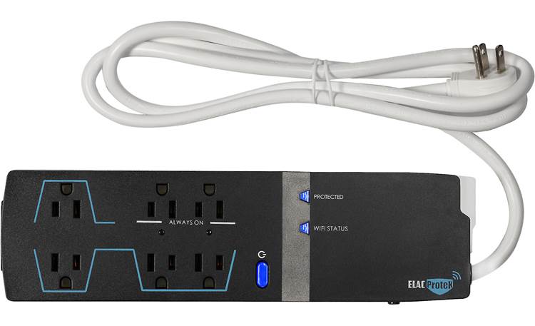

If you decide to go with HSU you could just shut off the sub next to your wife’s wall by using this WiFi smart surge suppressor from Elac.
It also has an app and lets you program outlets.
