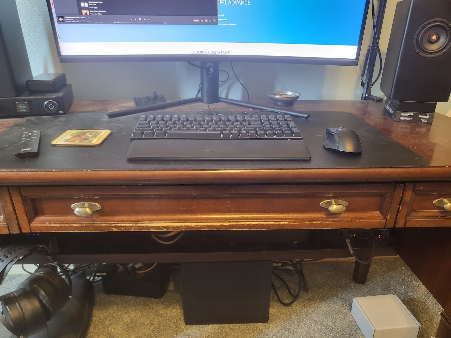

Started a new project. I have been intrigued by GR Research kits for a while, and I wanted something smaller to replace my LS50's on my desk. Will be strictly nearfield listening. I would like to get back to a majority of DIY for the stuff on my desk top (Computer, speakers, amplifier). Would have spent less money if I ordered the prefab flat pack boxes, but I want to redo my subwoofer box as well so I ordered a new router, bought a sheet of MDF and got to work. Plus I just need the practice.
The parts for the speakers are on order. I opted for the higher quality caps. I am actually considering ordering like value budget cross over components from parts express so I can assemble a budget cross over and an expensive crossover to see if the difference is really that dramatic, I dunno though. The drivers are inexpensive enough that I may also just build a second set for work with the cheaper crossover.
I have a DAC/HPA that also acts as a preamp, that routes into my subwoofer. The subwoofer sends the highpass signal to my DIY ICE power stereo amp, then to the speakers. I will probably highpass them to 100hz. Sub is an 8inch Dayton with a Dayton amplifier.
Will probably do DIY room treatment next.
On to the pictures.

Well like I said before, I share your skepticism in the benefit I will get from the higher end crossover components; however, this kit is only sold with the higher end stuff, and I ordered it as a kit. There were a couple of factors helping my decision.
1. I got used to my KEF's so I wanted a single point source driver,
2. I wanted small,
3. Even if he preaches heavily about the higher end components (you should hear him talk about "tube connectors") Danny Richie's crossover/speaker designs are usually highly respected in the high end audio community.
This is one of his lowest priced kits, and it fit the bill perfectly for my use case. His crossover schematics aren't posted anywhere on the site, so I am assuming he will ship those as part of the kit. If I searched, I could probably find a schematic for that kit online and save quite a bit purchasing the more inexpensive components, but I like to support American companies, and I like the small business feel he has.
Plus it will make good youtube content when I have my son do blind listening tests with the expensive crossover, and the cheap crossover. I just gotta decide if I really want to build a second set. Guess I will have to finish the first one to decide if it is worth it.
