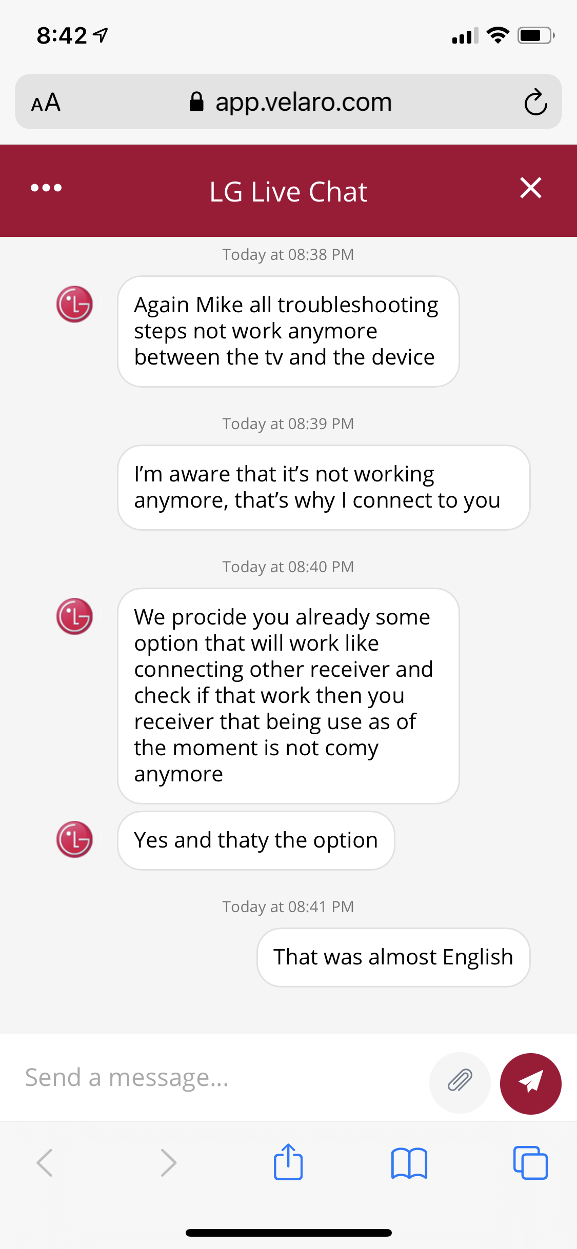

My TV stopped automatically recognizing my Marantz receiver about a week ago and I have to turn it on and turn it off several times along with the receiver before they shake hands. Here is LG’s customer support suggestion.
“Turn off the TV > Unplug it from the outlet > Press and hold the power button of the tv itself for 10 to 15 seconds > Plug it to another outlet then turn it on”
“It will helps to refresh all the components on the TV”

The person in tech support could have spoken in their native language and said "That was almost 'XXXXXXXXXXXX".
If you want to pay more, they can use US-based support. If not, deal with the different languages and give them credit for trying to communicate with people who think that English is the only one. Considering the fact that English is one of the most difficult languages, he didn't do too bad.
