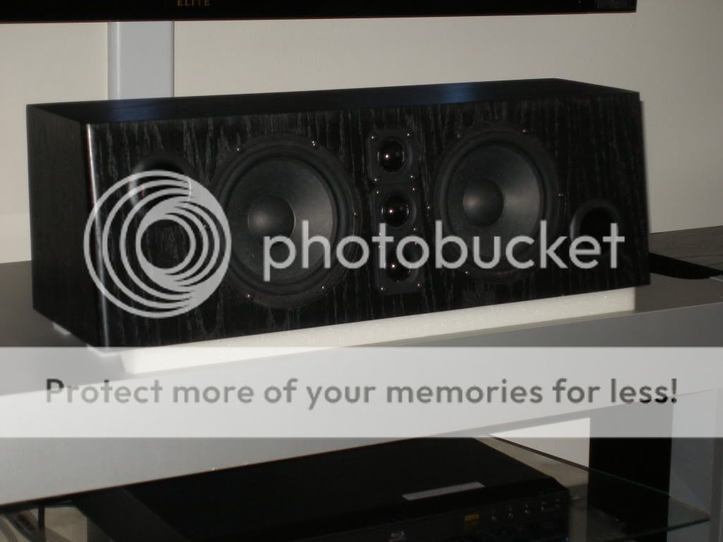

BTW since we pulled the center forward it realy shines.

looks good. you are lucky to have someone help like that.
no grill for the center ?

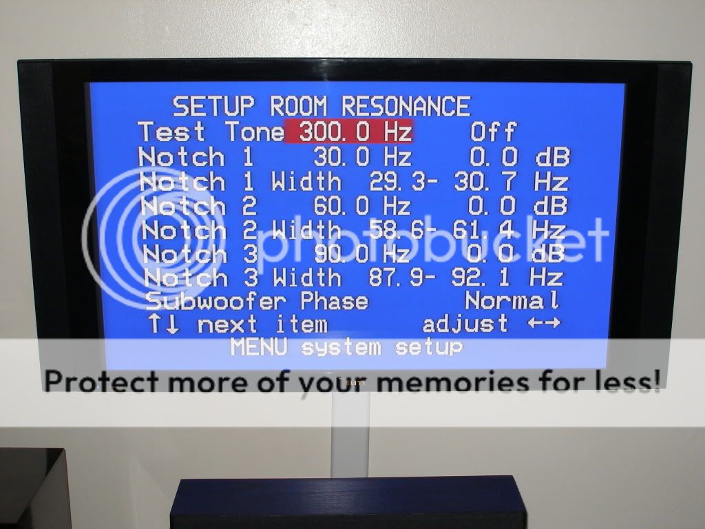

I'm not so sure that it would, Alex. The thing I was talking about is like a big, broad paintstroke of an EQ, and something that is named "Room Resonance" sounds more like a single band, or maybe a couple/few band type of cut EQ. Totally out of my butt on that, but that would be my guess.
Tell me the name of the processor, and I'll see what I can dig up.
It's an older B&K Ref 50 S2. I don't think I'd want to play with these settings. I might just get lost.

I suddenly got it. Between looking at that pic and having skimmed that review link that I PM'ed you it became clear(er). It appears that there are 3 filters there at 30, 60 and 90 Hertz. Take a look at the Rives Test Graph and see if there is a peak at any of those frequencies that you could cut by a certain number of decibels to produce a flatter response. Oh you are deep into the sh!t now. I hope your neighbors like the sounds of test tones. You simply have to read that manual and get your mind around what all that processor can do to further refine your speaker's ability to reproduce sound faithfully. All I'm ever concerned with is one listening position. It's always been all about me, me, me. :)

For those who want to help Walter understand his machine, here is the manual:
http://www.bkcomp.com/fileadmin/content_products/manuals/ht_manual/Reference 50_S2_UM_13790_1104.pdf
A few things that I noticed were that you can set memory for any setting (which could be nice to A/B compare if ever desired), and that while the xover settings aren't ultra advanced, it's still a lot better than what the great majority of us have with deciding xover slopes to the sub. You can have 6, 12, and 24 db/8ve slopes (AKA 1st, 2nd, and 4th order crossovers). I would imagine that I personally would use the steepest slope, due to my placements and equipment being used. The lower the number you choose, like 6db/octave, means the more you will hear the higher end of the sub for instance. With that chosen also for the high pass, you would hear more low end from the speakers. I have absolutely no idea what the implications are when different slopes are chosen at the same time between sub and speakers, and if you find out, I would love it if you told me here or by PM.
Finally, for the notch filters, if you don't want to tinker for now, just leave them be, until you one day figure out that you have modal/ringing issues at any of those very particular frequencies. OTOH, you can just tinker to taste. The main compromise that I find (and am still finding, and am forced to continually tinker with my own sub EQ), is that dialogue can be masked if the midbass is too powerful. I think anyways. I dunno, maybe not, but it doesn't sound quite right, although I'm sure subjectivity might play a large part.

Oh I forgot to address some things. The "width" on the screen is surely affecting the Q, or just how "wide" of a passband is being affected. Q does not affect the deepness of the cut, so to speak, only the width. Does that make sense? It's not entirely unrelated to the idea of the differing slopes with xovers, but ignore that because I'm sure that may greatly mislead you.
For subwoofer phase, I think the easiest way is to have two people. Actually, in your case, nevermind, just you is fine (I'm so used to phase adjustment only being on the sub itself).
Use bass heavy music. The better phase adjustment will have the bass sound more full at your LP, and the worst adjustment will have it sound anemic.

Recently I got that THX Select rec'r and it's slopes match what Walter's are set at. 24 db/octave low pass and 12 db/octave high pass. My old (I assume inferior) H/K was 12 db/octave (I assume for high and low pass) according to an H/K rep. *shrug*
IIRC Walter had a bump from 125Hz-250Hz but I'm not sure that he can adjust where the notch filter is ... oh, but wait ... I think he can adjust which frequencies are affected by his tone (bass/treble) controls. Let the tweaking begin.

Thanks for all yor input. This is what I am going to too bevore I start messing with the settings. I am gona take pictures of all the factory settings so I can reset them just in case I screw things up and no Heinekens tonight. I might have to skip tonight and enjoy the system instead of tweaking it since tomorrow is my birthday and I have to get an early start.

If I were you I wouldn't tweak anything until fall when you have time away from work and you have had time to read and understand that processor. Right now the system is good to go and it's unlikely you will improve on it without a way to take even rudimentary measurements. There's no hurry here. Enjoy the system as is for a while and get to know what that sound really is like so that you have an established bass for future comparisons. Who knows? ... maybe by the time you have time to really do the deal and have your room treatments up, I will have REW figured out and we can take some really fancy measurements.

I set it to 6 and it sounds very good, almost like a DBX dynamic range expander, kind of fills it in.
