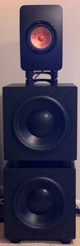

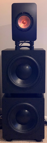

I've always been fascinated by Bill Dudleston's larger designs. He creates some very compelling speakers and I'm a fan of DSP and active designs.
I do, though, depart from not just his, but everyone's speakers when it comes to the efficacy and necessity of $8K, passive, monkey coffins such as this.
A well designed 2.2 sub/sat system will give you superior performance for the same price or less. The reasons are manifold: true active bi-amping, low bass not polluting the mids by having separate cabinets, the freedom to place the satellites where they image the best while placing the subs where they offer the smoothest in room performance, etc. These are substantial advantages you can't get from any single cabinet loudspeaker.
It is a bit more of work to set it up, but the pay off is worth the pain. Anyone who will spend $8K on a pair of speakers should know enough to sort out a sub/sat system in about the same time as these boxes.
What crossover frequency do you use for the pictured set-up?
