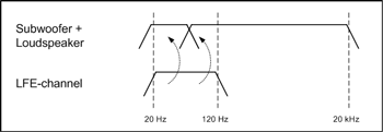

Do woofers totally shut off when placed as a small?
The woofers in your speakers? No. They're still playing those lower frequencies but they're gradually rolled off at the crossover point where they hand off to the subs. If using a subwoofer I would always set my speakers to small.

No they definitely don’t just shut off. Especially with normal XO settings in the 50-110hz range. What your basically doing is tailoring how much bass is produced by the speaker, or the subwoofer. A kind of sliding scale. The higher the XO the more bass comes from the sub, and less from the speaker and vice versa. On paper it kinda looks like this.

Depending on what "down to 25 hz" means I'd say set your speakers to small and start out with a 80 hz crossover. "Down to 25hz" could mean 3 dB down or 10 dB down unless specified. Meaning they might be able to reproduce those low frequencies but not with much authority. Subwoofers live in that frequency and in general do a better job of it than most speakers.
Try the small setting, 80 Hz and go up or down from there and see what sounds best to you. My Ultra towers are legit capable -3 dB at 28 Hz and I was using a 100 Hz crossover because they just sounded (and measured) better that way. In my experience a higher crossover will give you more texture and punch if that's what you're lacking, but truly capable speakers with optimum placement can sound great with a lower crossover. That's very room dependant tho, and the placement of your speakers play a huge role. Subs are a bit more flexible in that you have more placement options to maximize performance.

The above diagram does give the gist of it. However your choices are different by brand. I'm an outliers here and believe that where possible speakers should be set to large and not small unless you absolutely have to. With Marantz gear you can set the speakers to large and send some of the bass to the subs. The LFE is sent to the subs.
