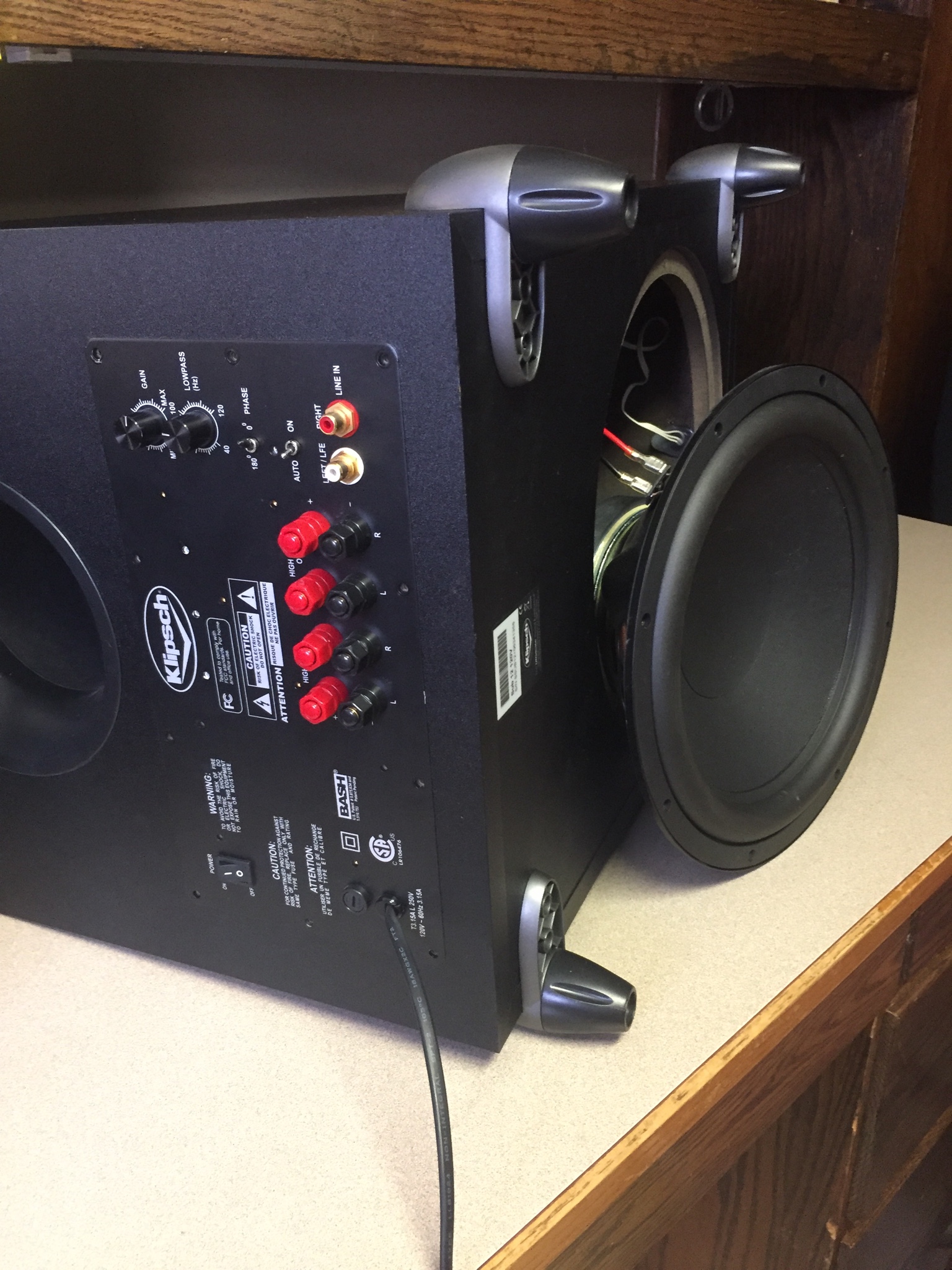

Just purchased a Klipsch Sub-12 second hand. It powers on and works. However I need to push the gain knob in for it to work. The gain knob in not loose, just simply need to push on it for the sub to receive signal. Just wondering if it’s loose wires? I don’t want to begin ripping it open until I hear some opinions. Thank you.
Is it just the knob sliding on the post or do you think the whole assembly behind it is moving? Is it like a slotted post or held on with a set screw? Can you simply remove the knob to see if it's cracked or something? Personally I'd take the amp off so I could see both sides if it seems like more than the knob.

The knob is not damaged, turns normally. It’s %100 behind the knob.
You comfortable with disassembling the sub? Sometimes taking the driver out first can be easier to deal with the wiring on the driver depending how much slack they left. Use the right tools...

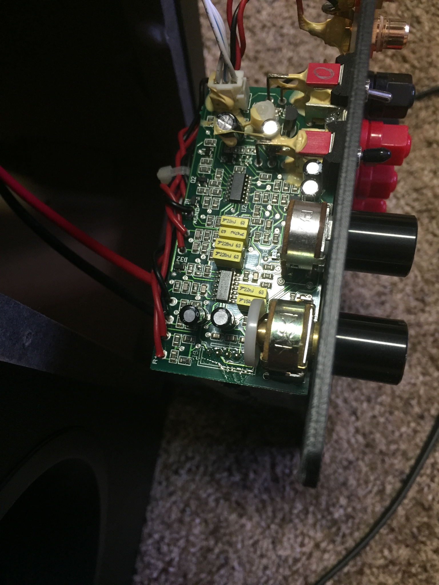

The gain dial is bottom one. Nothing appears to be out of line.
So when you push on the knob now that you can see that side, nothing is visible or ?
OK, so you are going to have to take the board out.
I think there are two likely possibilities.
1). That there is a either a dry solder joint or break in the etched circuit board near the solder joint of the potentiometer control.
2). The potentiometer has failed and needs replacement.
You can test 1 with a multimeter on the 0 to 100 ohm range.
In turn put a probe on each pin of the pot and see if there is continuity to the next point on the PCB board. If one is defective then resolder the pin and or any break in the PCB.
To test the control (possibility 2) then put the probes on the center pin and the upper one. Turn the gain full, there should be zero ohms on the meter. Now turn it anticlockwise, in other words decrease gain. You should see the resistance increase as you turn the knob. You will have to set the meter to 10K ohm or 100 K ohm range for this test.
If it fails this test then the control needs replacing.
Now you don't really need the control if you have a receiver as you can control the volume from the receiver. So you could just jump the center pin to the upper pin, by soldering on a short piece of copper wire to the center and upper pin of the pot. This will leave the sub on max gain.

The “pot”. I finally figured out what a pot is, and how it works. My guess is that a soldier point on the track broke. I have a solder iron but it’s big and bulky and won’t fit. I found a guy who can do it for $50. Is that worth it?
If you are going to buy second hand gear, then you need to have a decent soldering iron and know how to solder.
Please describe to me the results of the fault finding I outlined.

Ah, I’m just going to replace the whole pot. I got the sub for cheap and I can get even more money back since it’s not functioning correctly.
