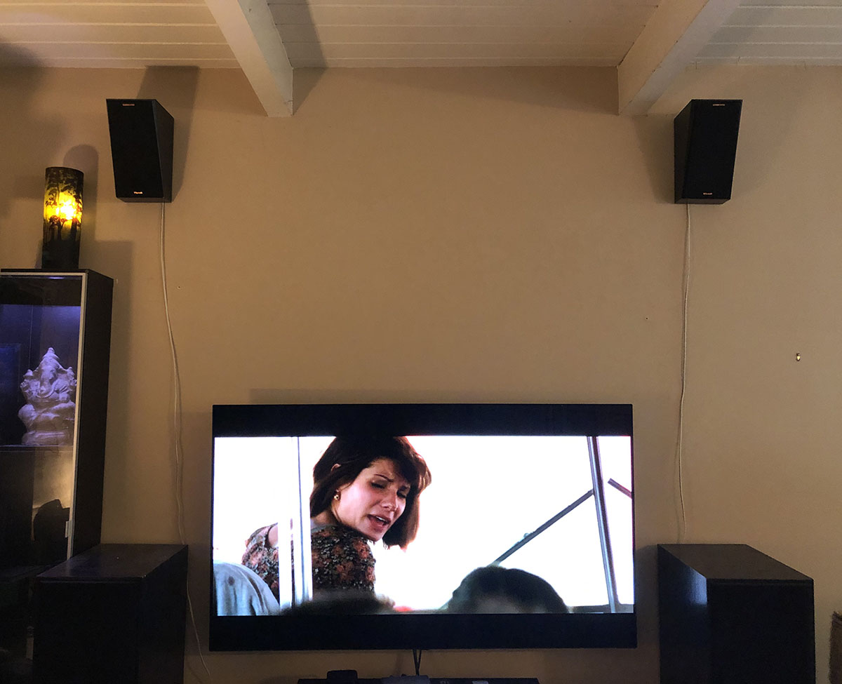

I am using Klipsch RP-500SA for ATMOS speakers. When I first got them around October last year, I put them on top of my front left/right tower speakers to try the up firing bounce effect. Used the AVR's setup to set those speakers as being on top of my front left/right firing up. The switch on the back was already set to ATMOS. So I left that alone. I do not have an ideal ceiling at my place. See attached pic. The results were not that impressive. Though, at times with certain shows, it did seem like there was a bigger area of sound. And a couple times it did sort of sound like a helicopter or plane, was flying above.

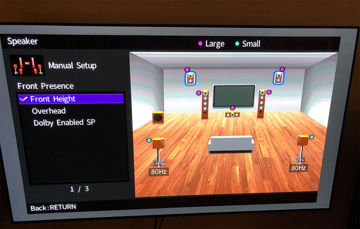

Fast forward to today, where I had my buddy help mount those speakers to be high on the wall. Near the ceiling. I ran the Yamaha speaker set up tool again. Now I designated those RP-500SAs as being front Height presences (atmos?) . And now I'm wondering about that switch. I called Crutchfield tech support this morning. They are generally great to deal with. But the tech person suggested to try it out both ways and see which one I liked the best. So I left it as "ATMOS" and have been checking out a few shows. So far, it's been an improvement over the up firing set up. And now, I'm going to flip the switch to "SURR" and test that out. But I don't understand why I should switch it. Thankfully, I just get on my step ladder and flip the switch.

So I wanted to try mounting those speakers on the wall for "Front Presence / Front Height" as the Yamaha setup menu calls it. As opposed to "Dolby Enabled SP" with firing up, for the bounce effect.

The reason to set to Atmos or surround is that those can be used as either. When the switch is set to Atmos, it activates a notch in the frequency band that helps the brain “hear” overhead sounds from those speakers. When set to surround, it just acts a a a regular speaker. Then when mounting in the wall as you did(much better choice) setting them to “surround” is correct. You also have to rerun audyssey so it doesn’t try and “correct” the notch out of the speakers. Setting them in the AVR to Atmos enabled or height/top will make a big difference.
