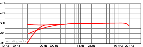

Here is the famous Neumann U 87. I have the dual capsule stereo version. This is the omni response. This is one of the most widely used microphones of all time.

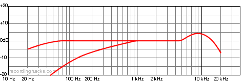

The Shure SM81
The discontinued SM80 omni which I have is similar.
