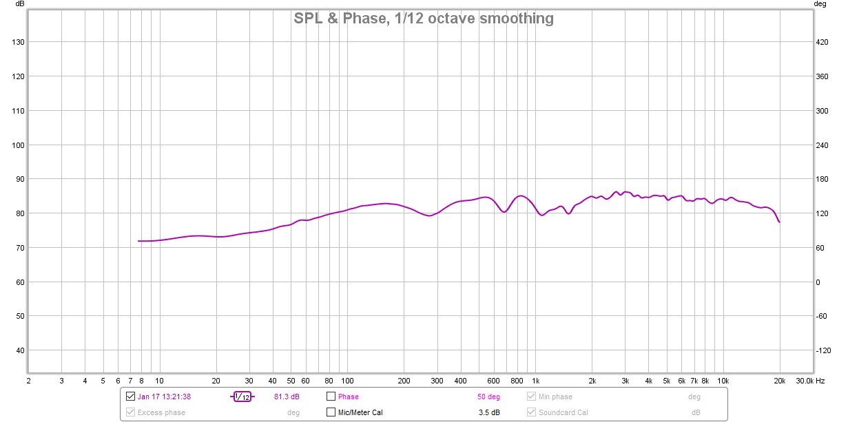

The scale of that graph is much too broad and is hiding how rocky that response actually is. An amplitude range of 50 dB to 100 dB would be a lot more revealing of its behavior. Also narrow the frequency range down to 300 Hz to 20 kHz. Also are you sure that your window is only 300 Hz? I would be surprised if you are able to measure accurately down to 300 Hz if this measurement was taken indoors in a room with a regular 8' ceiling.

I'm not familiar with your measurement software. If that's really a quasi-anechoic measurement above 300 Hz, I think there's something off in your mic calibration above 10 kHz.
It's a calibrated omni mic using rew. That was measured at 1m on tweeter axis and a 6ms window was applied by using the impulse response to determine when the reflections arrived.
I've actually taken several measurements of these speakers and always gotten the same results. Do you mind pming me your measurements? I know the audyssey app, which shows before and after response graphs also shows something very similar to what I got.

I think you have the measurements now. I sent a speaker to the Canadian NRC to check my measurements, and they are virtually identical, so I'm sure of my results above 10 kHz. They also track Sound and Vision's measurements, and they had a grill on, which I didn't.

After getting your pm, I reread your post here and saw that I hadn't glommed on to the fact that you were using the Parts Express Omni Mic. I just thought it was some kind of omni-directional mic. That explains your measurements. As I mentioned to you in my pm, the PE Omni Mic is severely rolled off at the top end despite the calibration file you get. I wish they could fix that, because it's a very nice piece of hardware and software. I use it for THD measurements, which don't extend above 10 kHz. But it's not very useful as a design tool.

In addition to the Omni mic thing that Dennis mentioned, I think to get a better picture we really need to see 1/24 or even 1/48 smoothing.

Are we sure the calibration file was inputted? Also I could almost swear that was a measurement he posted using the audyessey Mic before .
Don't know about the Audyessey Mic, but when I measure the Klipsch using my OmniMic, I get pretty much exactly what the OP got. And my BMR measures way down in the highs with the Omni, which it isn't, unless the NRC and Sound and Vision mics are off in the same direction and to the same degree as mine. I've had discussions with at least 4 other Omni Mic owners, and they all have the same problem. Jim Salk's is so far off in the highs that he can't use it for anything.
