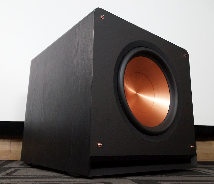

Klipsch has been one of the few major loudspeaker companies that have made some reasonably high-performing subs for home audio instead of many of the lackluster designs from other loudspeaker manufacturers who only phone in subs as an over-priced afterthought (think any company that makes tower speakers but then only makes 8” or 10” subs for the same series; in other words, subs that wouldn’t add much bass extension to the loudspeakers they are supposed to support). For example, Klipsch was one of the first companies to offer THX-certified Ultra subs for home audio systems. We found the last sub we reviewed from them to be competent although not as competitively priced as it should have been (Klipsch Reference R-121SW Review). Today, we look at a sub that few other major loudspeaker manufacturers would dare launch: a 110 lbs. ported behemoth with a 16” cone powered by an 800-watt amplifier. It’s a big sub, and Klipsch is one of the only loudspeaker-centric audio manufacturers that has such a beast available.

It always interests me the influence of marketers over engineers. I detect them at work here.
Clearly the vent air velocity is too high. However, my guess is that if they had reduced the vent air velocity then the vent would have been too long either for the box and or vent resonance problems.
You can see that the likely slow drop would be around 30 Hz, judging by your detailed graphs, and the 12 db per octave spl. drop off starting around 30 Hz.
I think that actually this would have been a much better and more useful sub with a standard B4 alignment. Sure it would have had a slightly higher F3, but the port would not have chuffed and I bet it would have actually sounded better. Of course the sales staff new better, and we have to have 16 Hz for the glossy literature.
The fact is that precious few domestic rooms need a response to 16 Hz, and they actually will get it as a rule due to room gain at those frequencies.
Bottom line fire the marketing department!

Great writeup @shadyJ I was wondering in a box that size if youd end up with Chuffing at that low of a tune.
Still it's really hard to hear it in real world use I've found. And it sounds like you had a hard time hearing it in real world usage. Also factoring in room gain in most residential sized rooms I doubt you'll need to run this at its limits to get the SPL you want which will help with limiting Chuffing.
Then factor in using multiple.subs and even less of a need to drive your subs past certain levels it should help these subs a lot unless your running Edge of Tomorrow at crazy levels.

Agree with @TLS Guy re: port… it’s disappointing to see the comments about chuffing. We all know there are trade offs throughout the design process, but to allow something through to actual sales which doesn’t meet standard is a shame.
I can think of several instances where Shady has commented in other reviews where he couldn’t cause the sub to make a bad sound due to protections built-in via DSP or proper design.
Regardless, it’s hard to consider this an SVS “killer” with that performance drawback being noted.

When I say "couldn't make a bad sound," I mostly mean high distortion from over-driving the cone. That is the one to worry about since that can put the sub in danger. Chuffing doesn't put the sub in danger by itself, and most ported subs can be pushed into port turbulence. In fact, I can't think of any that didn't off the top of my head. However, some only do it mildly. The problem with this sub is that it would run into port turbulence pretty early on as I raised the levels, at least at 20Hz and below. It's still a very good sub. And port chuffing is easily addressed by making the subwoofer face away from the listening position since that sound is fairly directional.
