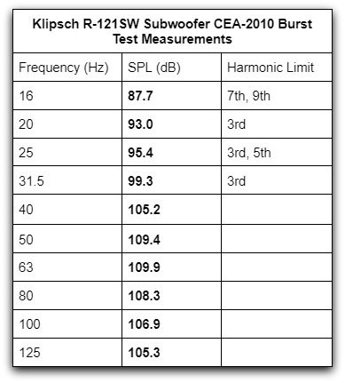

Shady, I have trouble to see how you can really recommend a device like this. Honestly is only virtue is cheap.
You can't have a serious design using half inch MDF for any panels.
This is a classic "thumber" sub almost certainly done with malice aforethought.
The sub peaks at around 60 Hz, the "thumper" frequency.
The sub is 10 db. down by 32 Hz.
That was done on purpose to make an impressive thump in the show room.
The shame is that this could be a far higher quality sub, with only the extra cost be 3/4" MDF all the way round. That cost would be minimal.
I think one better sub would easily best two of those.
You don't have to tolerate a sub like this and maintain price.
Below would be a high value ported sub, of reasonable dimensions.
shadyJ
Speaker of the House
Staff member
Regarding your criticisms of the paneling, the half-inch MDF panels do have some bracing reinforcement. Also, owners could easily and cheaply add additional panel mass or bracing if desired; that is basically the cheapest and easiest speaker mod that can be done. Some additional acoustic stuffing could also be thrown in there at low cost.
Per your criticisms of the response shape, I doubt that is deliberate. That is a classic inductance hump. It is expensive to address in the sub's design, and that is what all the low-cost subs that I have measured have had. You need to insert a copper or aluminum sleeve in the permanent magnet iron, and then you need to apply far more power to magnetize the iron since the shorting ring is fighting against the magnetization process. Even some of the more expensive subs have had some inductance-related issues affecting the response. Klipsch could have EQed that out in DSP, but that would add to the group delay, and you will note this sub actually does have very good time-domain performance.
Another reason why this response shape is not a big deal is stated in the review: the room is going to mangle the response regardless of how pristine it is in an anechoic environment. The room is going to determine the response shape much more than the sub itself. But the good news is that multiple subs can address this much better than a single sub, so I think two of these subs with their peakish response would be able to yield a better overall in-room response than a single higher-end sub that has a flat response.
I am not saying that the Klipsch is a great sub, and at its MSRP, I don't think that it is, and I say so in the review. But it often sees pretty serious discounts, and from $300 to $400, I think it is a pretty good value. At near $300, you are going to have a difficult time finding a better sub.
