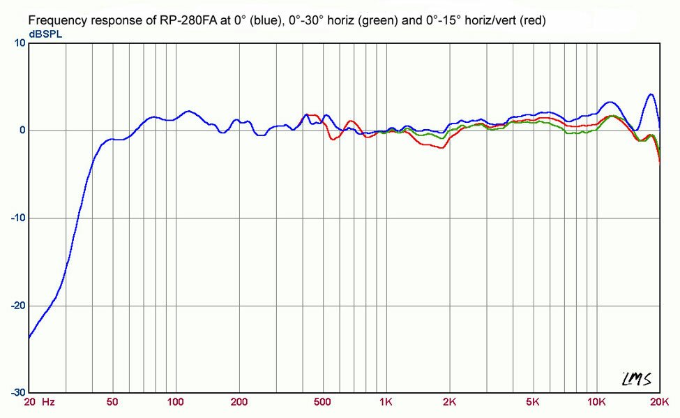

Klipsch sensitivity ratings are exaggerated, but the rp-280f measures at 92.5dB at 1w/1m. Here is the response graph
Klipsch-RP-280FA-FR-14534.php
. The RF 7iii should dig even deeper and play louder.
